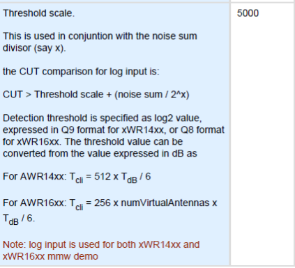

Hi
I'm confuse for the formula of CFAR threshold. In the SDK user guide, there is an example, if use 8 virtual antenna and the configure file set the CFAR threshold scale value to 5000, does it mean the threshold scale in dB value is 5000*6/(256*8)=14.65 dB?
