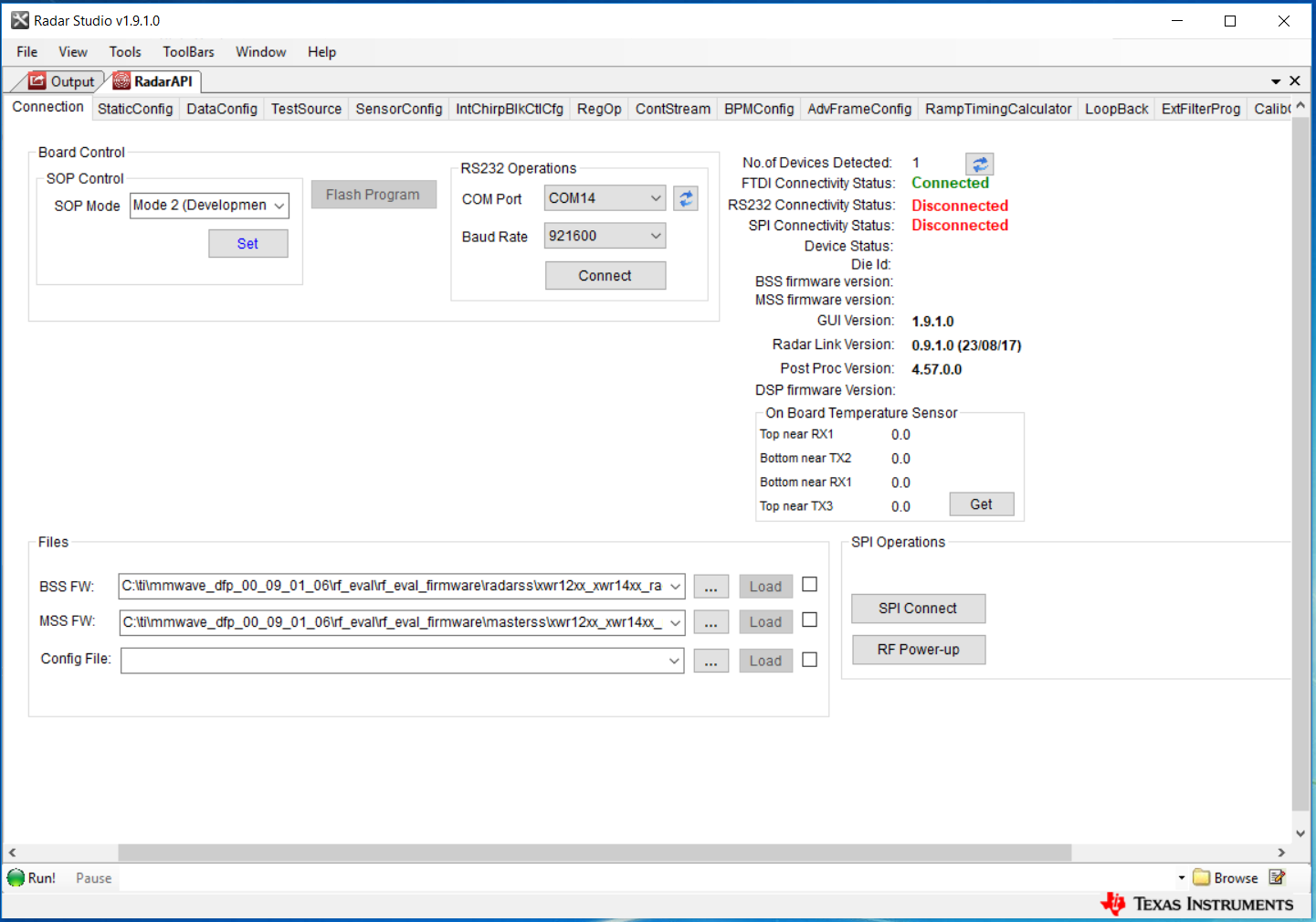

  • I am using AWR1243, and the latest DFP package 0.09.01.06. Before I click "set" for SOP, I can see dropdown of Single, Master, Slave options. However, as long as I click "set" for SOP, the whole dropdown disappears from the StaticConfig page as Thomas mentioned.
    Any solutions?
  • To Vivek,
    Correct my post, I am actually using DFP package V1.9.1.0. I think it is the latest one.
  • Hello RJimmy,
    Did you do RS232 Connect after doing the "Set" ? Once you do that the options should re-appear since it detects it as a AWR1243 device.
    Vivek
  • Yes, I did RS232 connect after doing the "Set". I still didn't see the cascading mode option. I attach photos here,
    1, before I did any connect.
    2, I saw cascading mode options
    3, After I press SOP, RS232 Connect. The cascading mode disappeared.

  • Hello RJ,
    I just doubled checked the scenario, the radar studio enabled the cascading options only when multiple AWR1243 devices are connected to the same PC. Other wise it assumes a single chip mode and disables the cascading menu.
    Vivek

  • Hello Thomas,
    The EVM presently available is intended only for single chip testing and not cascade. Plugging two of these single chip EVMs will not work since they don't have separate identifiers. We are working on having a cascade board available which would have multiple AWR1243 chips, once that is available you would be able to use the cascade feature.
