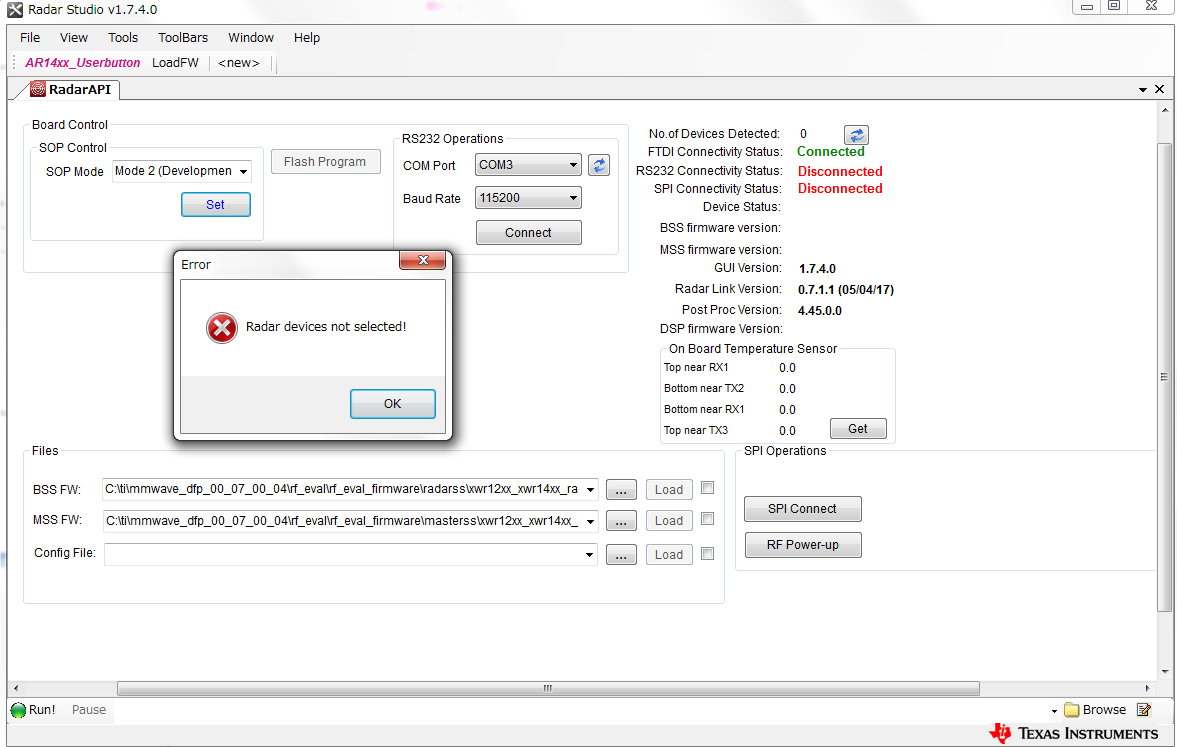

On the Radar Studio, "Error" appears when "MODE2(Development)" is selected and clik the "set" button.
How do I erase this errors?
Iwao Nouchi
    I'd be happy to help you but I need more information from you at this time. Would you be able to post a screenshot of your error?

    Thank you for your reply.
    The screenshot of error is as follows.

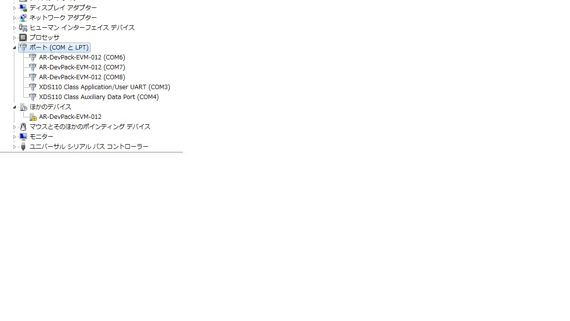

    I confirmed COM Ports.
    One of “AR-DEVPACK-EVM0-12” appears with a yellow label.
    I try to update the driver soft, I can’t install the driver soft of “AR-DEVPACK-EVM0-12” on the yellow label.
    Iwao Nouchi
  • Hello again Iwao,
    The “AR-DEVPACK-EVM0-12” device with the yellow label is going to be your problem. You are going to want to perform the following steps:
    - Right click “AR-DEVPACK-EVM0-12” with the yellow label, select "Update Driver Software," and then "Brows my computer for driver software."
    -Select the following directory: C:\ti\mmwave_dfp_00_07_00_04\rf_eval\ftdi
    The label should appear with the other 3 COM ports and you should be clear to use Radar Studio.
