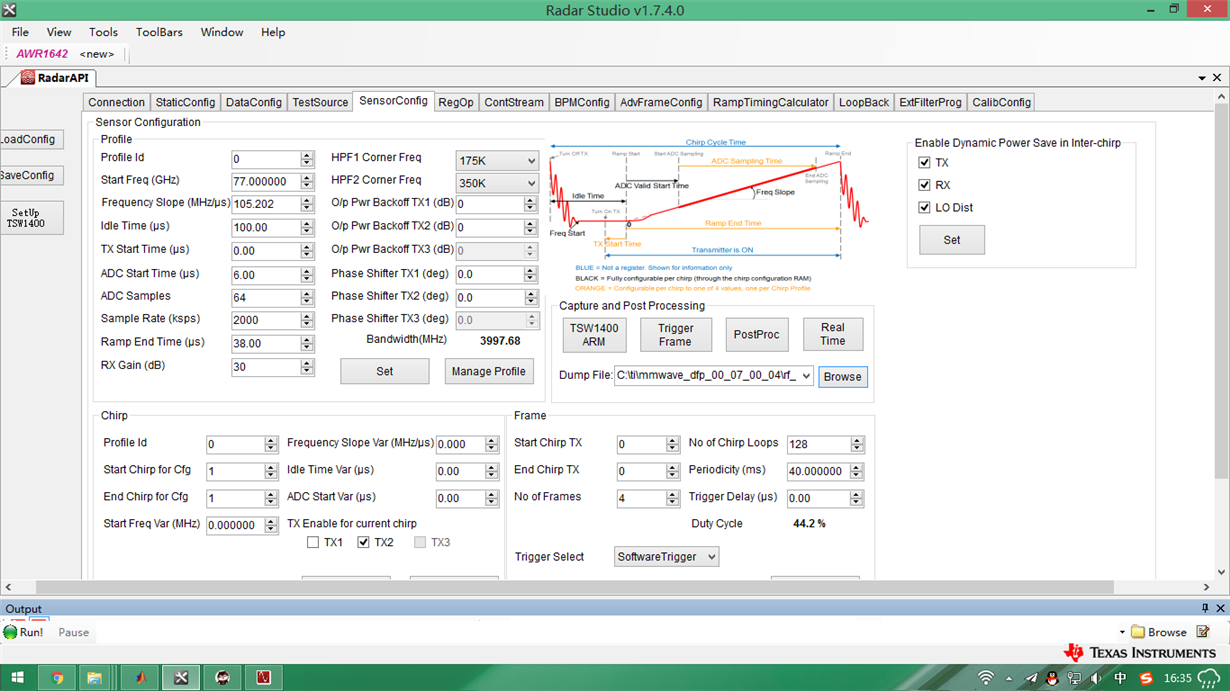

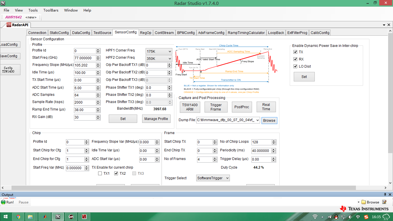

I got the adc_data after watched the video "mmWave Sensor Raw Data Capture Using the TSW1400 Board"  with AWR1642 and TSW1400.
So,following the tutorial, I hit "TSW1400ARM", "TriggerFrame" and "PostPorc" in sequence.
When I want to process the adc_data. I hit the button  "PostProc" , but  it doesn't work.
I had reinstall sdk and matlab_runtime, but it still can not be solved,
Can you help me solve the problem?

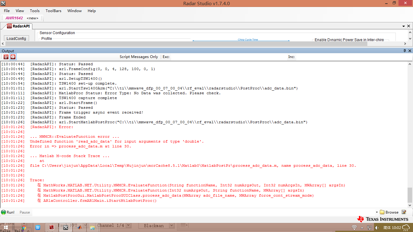

    Sorry about that, I failed to post the screenshot. I will try again.
    Could you see the screenshot this time?
    Thanks a lot!
    Jinjun

  • Hi Jinjun,
    The snapshot shows that no data was connected. Can you confirm that your TSW1400EVM is able to collect the ADC data ?
    -Raghu
  • Hi,Raghu
    I' m sure that I can collect data, and I run the matab code to process "C::\ti\mmwave_dfp_00_07_00_04\rf_eval\radarstudio\PostProc\adc_data.bin"  successfully. I checked that the range detected is pretty good.
    But I cannot hit the button "PostProc"  to get result in Radar Studio.
    Jinjun
  • Hi Jinjun,
    Could you share two files?
    1. "C:\ti\mmwave_dfp_00_07_00_04\rf_eval\radarstudio\PostProc\adc_data_log.log" ?
    2. "C:\ti\mmwave_dfp_00_07_00_04\rf_eval\radarstudio\PostProc\adc_data.bin" ?

  • 31-Oct-2017 16:22:41: IsFPGA:,0,0,
    31-Oct-2017 16:22:41: C:\ti\mmwave_dfp_00_07_00_04\rf_eval\radarstudio\RunTime,0,
    31-Oct-2017 16:23:12: API:select_chip_version,AR1642,0,
    31-Oct-2017 16:23:13: API:select_chip_version,AR1642,0,
    31-Oct-2017 16:25:36: API:ChannelConfig,3,15,0,
    31-Oct-2017 16:25:36: API:AdcOutConfig,2,1,0,
    31-Oct-2017 16:25:36: API:DataFmtConfig,15,2,1,0,1,0,
    31-Oct-2017 16:25:37: API:LowPowerConfig,0,0,0,
    31-Oct-2017 16:25:46: API:DataPathConfig,1,1,0,2,0,
    31-Oct-2017 16:25:47: API:LvdsClkConfig,1,1,0,
    31-Oct-2017 16:25:47: TSW1400 Sampling rate : 600000000 7500000,0,
    31-Oct-2017 16:25:47: API:SetHsiClock,9,0,
    31-Oct-2017 16:25:49: API:LaneConfig,3,0,
    31-Oct-2017 16:25:49: API:LvdsLaneConfig,0,1,0,
    31-Oct-2017 16:26:07: API:ProfileConfig,0,1435384036,10000,600,3800,0,0,2179,0,64,2000,0,0,30,0,
    31-Oct-2017 16:26:32: API:ChirpConfig,0,0,0,0,0,0,0,1,0,
    31-Oct-2017 16:26:57: API:ChirpConfig,1,1,0,0,0,0,0,2,0,
    31-Oct-2017 16:27:12: API:EnableTestSource,0,1,0,
    31-Oct-2017 16:27:12: API:FrameConfig,0,0,4,128,8000000,0,128,0,
    31-Oct-2017 16:27:12: API:AdvancedFrameConfig,1,0,0,0,1,128,8000000,0,1,1,8000000,0,0,0,0,0,0,0,0,0,0,0,0,0,0,0,0,0,0,0,0,0,0,0,0,0,0,0,4,0,0,0,0,0,0,0,0,0,0,0,0,0,0,0,0,
    31-Oct-2017 16:27:18: Selecting ADC Device : ,AWR16xx_lvds_4Channel_ddr_4bit_par_centre_16_bit,0,
    31-Oct-2017 16:27:33: Setting the number of samples to 65536.,0,
    31-Oct-2017 16:27:36: Setting the sampling frequency to 7500000.,0,
    31-Oct-2017 16:27:36: HSDCPro Error Status = 1 Could not find error in "Automation DLL Error Codes.csv",0,
    31-Oct-2017 16:27:36: Setting the input target frequency to30000000.,0,
    31-Oct-2017 16:27:38: HSDCPro Error Status = 63 HSDC Pro GUI is not Open. Please open the HSDC Pro GUI before using the Automation DLL.,0,
    31-Oct-2017 16:27:38: Applying Trigger Settings,0,
    31-Oct-2017 16:27:39: HSDCPro Error Status = 63 HSDC Pro GUI is not Open. Please open the HSDC Pro GUI before using the Automation DLL.,0,
    31-Oct-2017 16:28:21: Selecting ADC Device : ,AWR16xx_lvds_4Channel_ddr_4bit_par_centre_16_bit,0,
    31-Oct-2017 16:28:21: Setting the number of samples to 65536.,0,
    31-Oct-2017 16:28:23: Setting the sampling frequency to 7500000.,0,
    31-Oct-2017 16:28:23: Setting the input target frequency to30000000.,0,
    31-Oct-2017 16:28:24: Applying Trigger Settings,0,
    31-Oct-2017 16:28:25: Clearing out the bin file.,0,
    31-Oct-2017 16:28:25: Applying Trigger Settings,0,
    31-Oct-2017 16:28:25: Reading DDR Memory...,0,
    31-Oct-2017 16:28:36: HSDCPro : Saving ADC Raw Data as Bin file at C:\ti\mmwave_dfp_00_07_00_04\rf_eval\radarstudio\PostProc\adc_data.bin,0,
    31-Oct-2017 16:28:36: Error in Data collection. Please try again. Make sure that there is sufficient time (2 secs) between arming and triggering the frame. Also, make sure that the LVDS is active on the AR device and that the TSW1400 is active with the correct firmware.,0,
    31-Oct-2017 16:28:38: API:SensorStart,0,
    31-Oct-2017 16:28:40: Clearing out the bin file.,0,
    31-Oct-2017 16:28:40: Reading DDR Memory...,0,
    31-Oct-2017 16:28:41: HSDCPro : Saving ADC Raw Data as Bin file at C:\ti\mmwave_dfp_00_07_00_04\rf_eval\radarstudio\PostProc\adc_data.bin,0,
    adc_data.rar
    I changed the config, but still cannot resolve this problem.
    Jinjun
