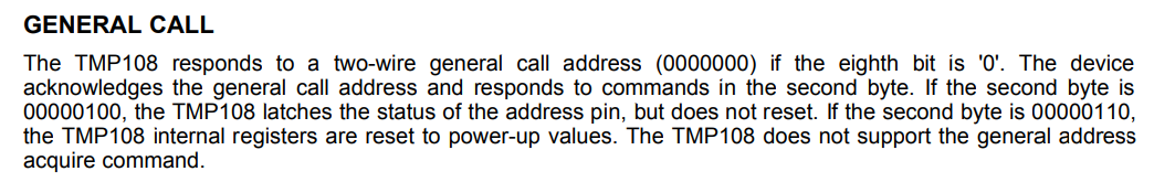

Our customer have some questions about general call command of TMP108.
At first, the address pin of TMP108 is set to GND and then the status of address pin is latched. Then the address pin should be set to VCC. At this moment, what is the device two-wire address of TMP108? 1001000 or 1001001?
The customer said the response of TMP108 after the first Byte of general call address (0000000) is ACK, but the response after second Byte of general call address (00000100) is NACK. Is this phenomenon normal?
