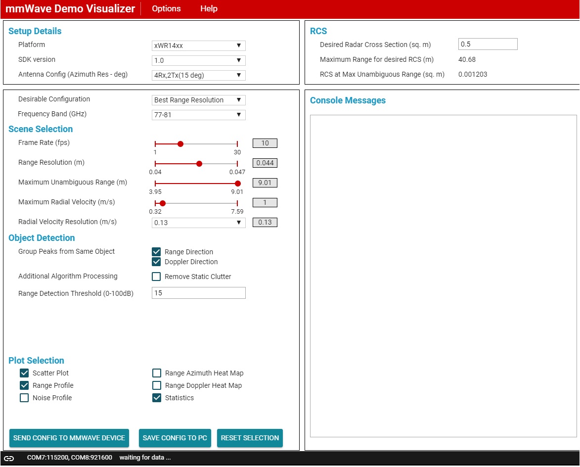

We have the IWR1443BOOST and are trying to run the out of box demo on Windows 10. We get far, then see nothing in the Console Messages of the Visualizer when sending config.

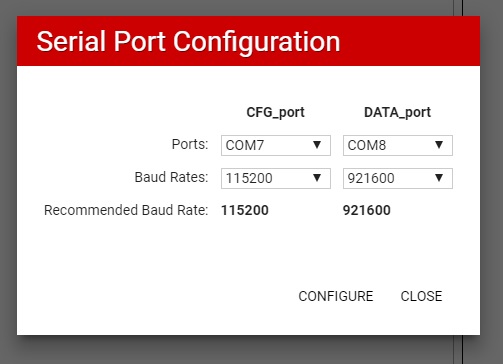

4. Plugged in the EVM USB and confirmed COM7 and COM8 as UART and Data ports respectively

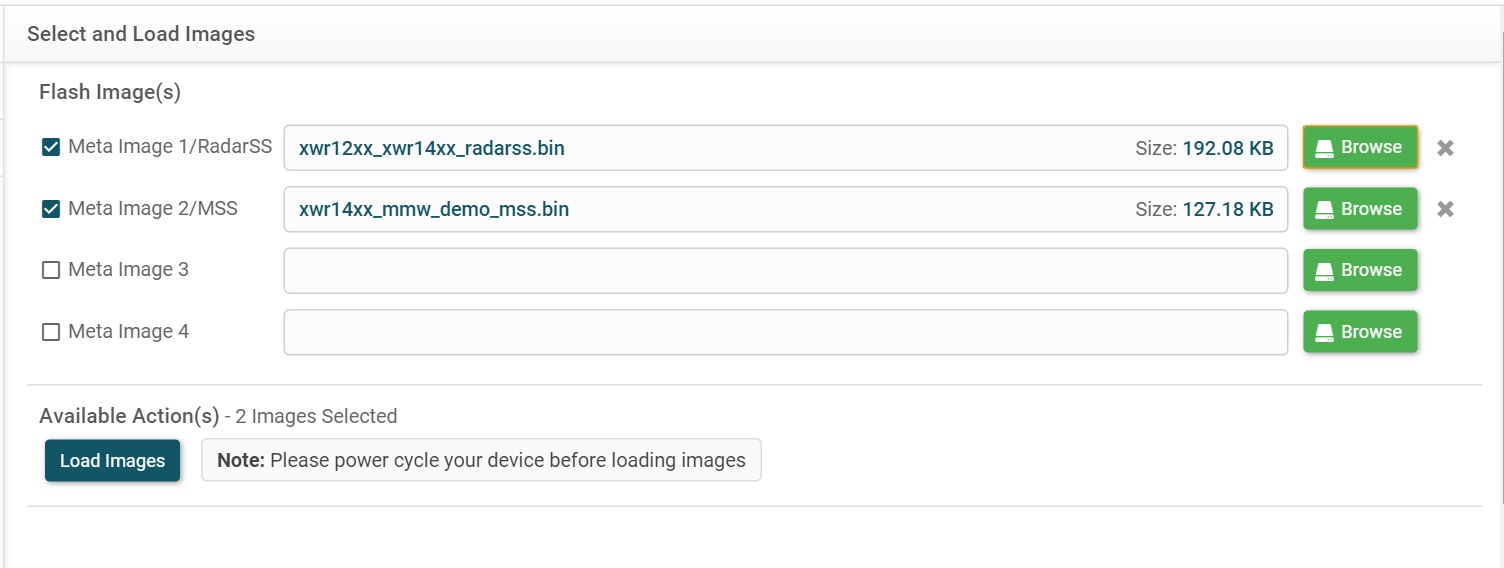

5. Successfully loaded the demo Image onto the EVM board (by way of manual selection/serial):
6.  Open mmWave Demo Visualizer and setup ports
7. In the Visualizer Configure screen: Set Platform to xWR14xx and SDK Version to 1.0 and leave rest as default. As you can see below, there at least appears to be a connection with the EVM, however it always says "waiting for data ...". After pressing the SEND CONFIG TO MMWAVE DEVICE button, all I see in the console window is nothing:
Also, I've tried the LOAD CONFIG FROM PC AND SEND with no luck either. I've tried a variety of reboots, powering down combos of the EVM, etc, with really no change. Is there other software I should have installed other than above? Any advice?

    Can you confirm Uniflash gave you a green-colored success message after flashing? (Step 5)
    Does switching the COM ports in the Serial Port Configuration (Step 6) do anything?

    Yes I do get the green success message after Uniflash. I have also interchanged COM7 with COM8 in the setup if that's what you mean. For some reason it seems like it is so close, but it just sits idle in the end.
    Is there something about the "waiting for data ..." message?

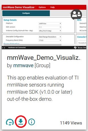

    Is there a way to download the Demo Visualizer and run it from the PC?

    Also, there is an offline version of the demo visualizer if that's what you were asking. Please go to the Gallery on dev.ti.com (link), locate the mMWave Demo Visualizer tile, and click the download button at the bottom left of the tile. The Linux, Mac and Windows environments are supported.
