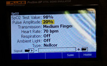

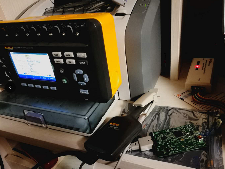

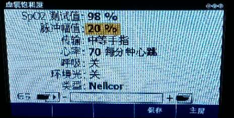

   I use the SPO2-FE EVM REV.A  demo to watch the PPG by Prosim8P,  the prosim8P setting as follow;     the hardware and the firmware doesn't change, the firmware and hardware use the default setting from the TI website.

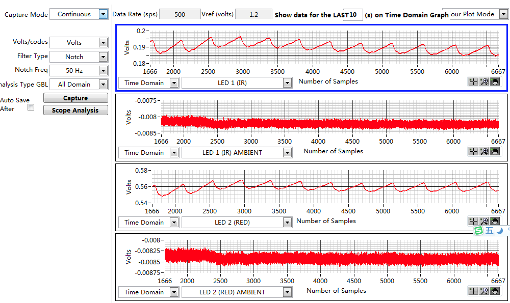

then i watch the PPG from the GUI as follow

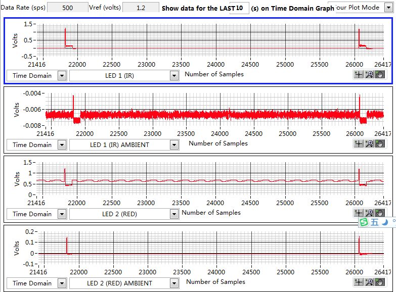

then i use my finger to input the pulse signal, then i watch the PPG from the GUI as follow:
I want to know why don't i watch the PPG with the Prosim8P setting?
