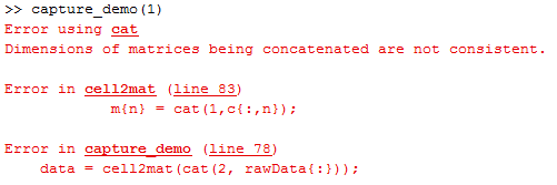

  • Raghu,
    Thanks for the response. In trying to use the demo I was able to visualize the data; however, when I tried to record data for a period of time, the resulting .dat file is not usable. I open it in MATLAB, for example, yet the file has only random symbols and no actual data. How do I go about fixing this?
    Cristian Soltero

  • Akash,
    I'm getting the following error when trying to run this capture_demo.m script. We made sure all the parameter values are set up correctly.
    Any  ideas on what the problem could be? Also, the .dat file that is produced from the mmWave record feature looks like a whole lot of nothing. Any help is appreciated.
    -jeff
  • Hi Jeff,
    I'm sorry but I don't have enough information to answer your question. As stated in my previous post, it looks like the source of your error is that the parameter values are not aligned appropriately. Your Matlab script isn't running properly which is why the resulting .dat doesn't contain any useful information. If you provide more information about the parameters about the parameters you are passing or possible changes you've made to the script then we can probably find the source of your problem.
