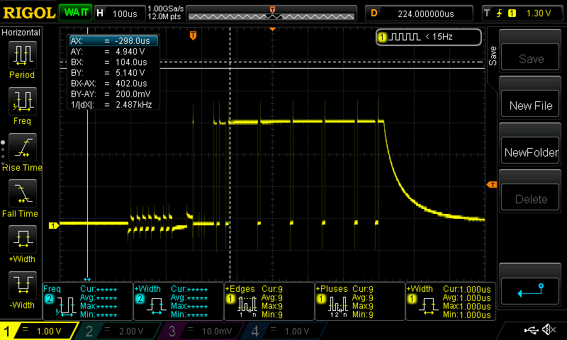

Now it is possible to configure the PGA460 on PGA460Q1SFF-DDFB (with a presaved config file), but when I try to make a measurement, the system is not working.
And i see this strange waveform on TXD line...attached you can find the picture...
I would like to know if it is correct or not...
Thank you for the support. Kind regards

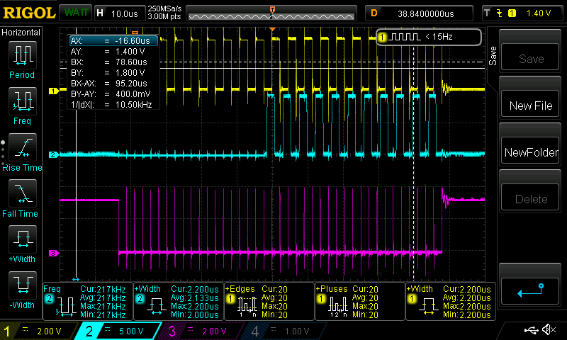

  • Hi Akeem,
    sorry for the delay in my answer but I was very busy in the previous days...anyway now I'm back to this topic.
    About the logic levels, I see that the only one problem is related to U6 (SN74AUP1T87DCKR), that accept 3.3V levels.
    U3 (DRV8870) and U2 (SN74LVC2G04DBVR) can accept also more voltage on their pins, without issues...Right?
    Anyway this parte of the circuit is working fines at the moment.

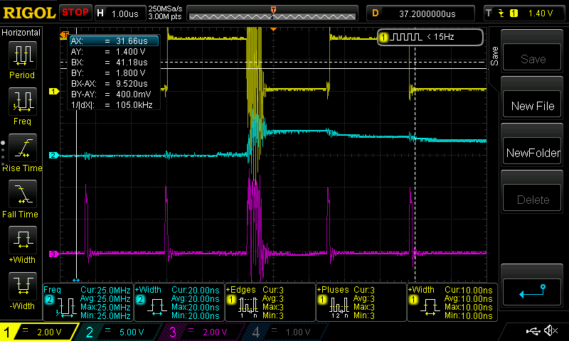

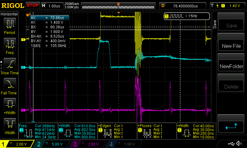

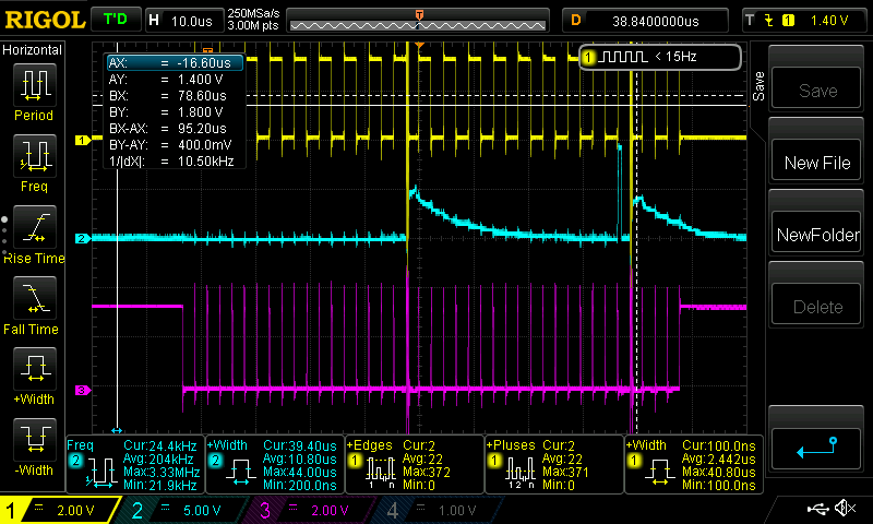

    I have issues related to the output of U6...attached you can find some waveforms.
    I assembled 2 boards: checking the waveforms, both has the same behaviour on U6 output;
    but one is working properly (figure below)
    and the second one no (figures below)
    zoomed waveforms
    To make the second board working, I had to put and RC low pass filter on the output of U6, before the gate of N-mosfet (Q1).
    Did you ever had issues related to this topic? I think it is better to eliminate the spikes in the drive signal for Q1. What do you think about it?
    Changing topic: Do you have a similar part number of DRV8870, with a sleep mode that can be controlled by an external uP? (ex. DRV8816, but this chip has no output fast enough to drive load as required...we need 220kHz).
    Let me know, thank you and kind regards
    Alessandro
  • Hi Alessandro,
    U6 (SN74AUP1T87DCKR) is limited to 3.3V levels, while U3 (DRV8870) and U2 (SN74LVC2G04DBVR) are limited to 5.0V levels.
    Thanks for the oscilloscope waveform captures. I haven't encountered the failing Q1 gate drive issue as you have shown, but I will try to replicate this error, and improve the overall driver implementation to eliminate CH3's periodic low-to-high transient during the burst duration. Ideally, Q1 should be active/ON throughout the entire burst duration.
