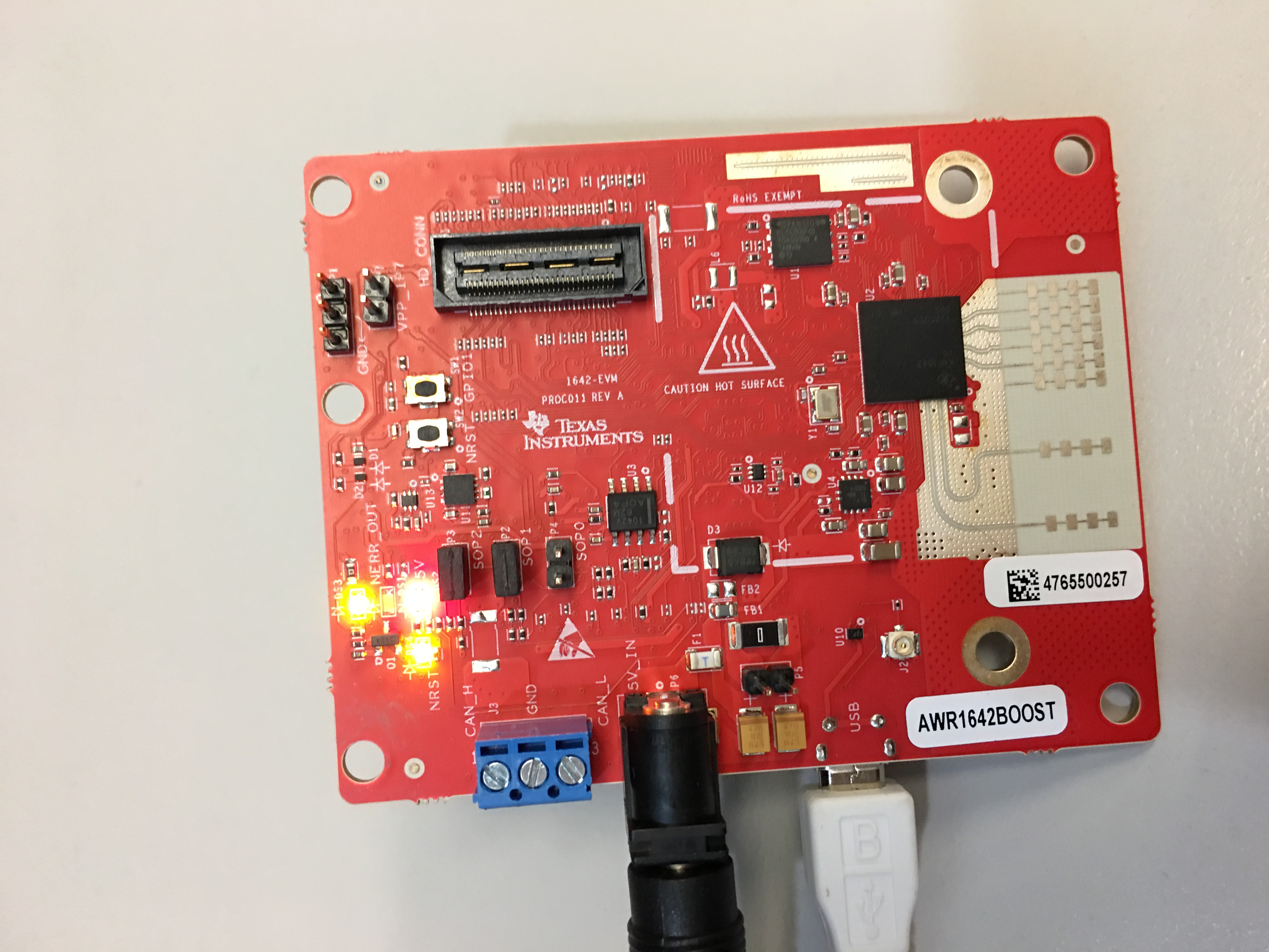

And SOP0 SOP1 SOP2=101.

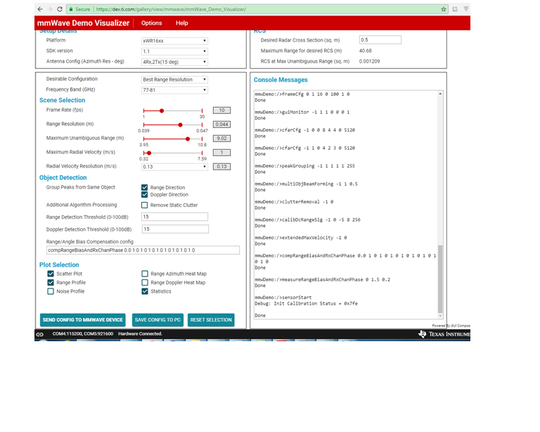

(2). Then I open   Visualizer in the Chrome browser. Select SDK version 1.1.

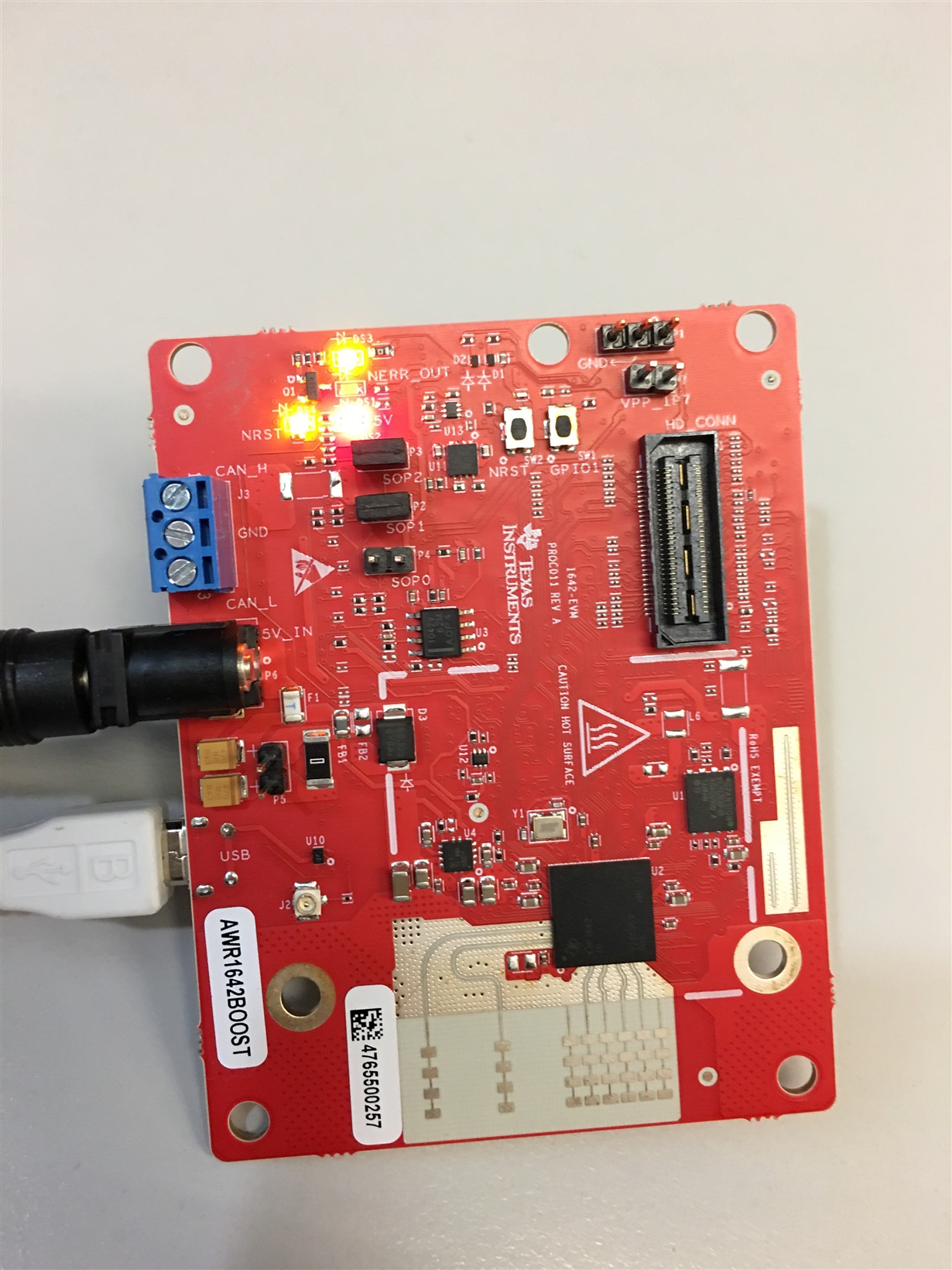

(3). Change SOP0 SOP1 SOP2=011 on the EVM. And power on the EVM. DS2 and DS4 are turned on.  DS3 is turned off.
(4). On Visualizer GUI, select Options/Serial port, then it shows "waiting for the data" on PC that is described on my above post.
(5). Click SENDCONFIG TO MMWAVE DEVICE, then it shows "Hardware connect", and on" Console Messages",
it shows "Done". Please check the attach. Then I note DS3 is turned on.

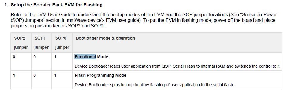

  • Mickey,
    Please see the below details in the user guide for functional mode and flashing mode settings of the SOP .
    Once you have flashed the " xwr16xx_mmw_demo.bin" to the AWR1642BOOST you will need to have only the SOP0(Functional mode) closed to use the mmwave demo visualizer.
    You cannot be in the  SOP2 and SOP1 closed as you have on your setup.
    Please change the SOP setting and you should be able to use the demo visualizer with your device.
    -Raghu
  • Hi Raghunandan,
    Thank you for your support. On page 12 of the AWR1642BOOST User Guide, it shows the different
    mode for SOP0 SOP1 and SOP2. Since these questions are very common than many customers ask,
    I would like to verify.
    Before I do not load the xwr16xx_mmw_demo.bin file to AWR1642BOOST, I cannot connect mmWave Demo
    Visualizer with AWR1642BOOST. After I load the xwr16xx_mmw_demo.bin file to AWR1642BOOST, and change
    SOP0 SOP1 SOP2=001(functional mode) or 011(dev mode), then I can connect mWave Demo Visualizer correctly.

  • Hello Mickey,
    A1: After flashing the xwr16xx_mmw_demo.bin , for functional mode only SOP0 is closed. and not SOP2 as mentioned in your query.
    A2: "dev mode" is development mode . To work in this mode , the flash should be clean and firmware is downloaded over SPI(Eg: RadarStudio) . You cannot have a functional firmware loaded in the flash and then work in the dev mode(SOP:011) .
    Raghu
