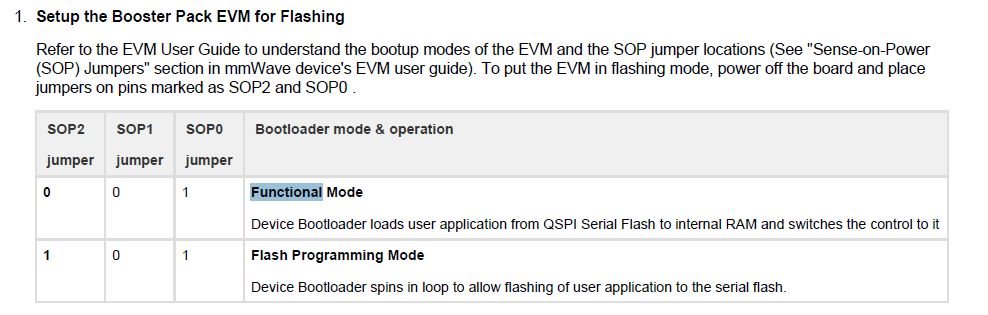

Hi team,
The customer is using AWR1243BOOST.  For mmWave Demo Visualizer, I note it only has xWR16xx and xWR14xx.
Q1: If the customer uses AWR1243BOOST, is mmWave Demo Visualizer incompatible with AWR1243BOOST?
Q2: For the firmware, is "mmWave Software Development Kit (SDK) " unavailable for  AWR1243BOOST?
And the customer needs to download "mmWave Device Firmware Package (DFP)"?
Q3: Can Uniflash be used for AWR1243BOOST? If this can be used, would you provide the detail steps for loading the file,
like load the xwr16xx_mmw_demo.bin file which is in "mmwave_sdk_01_01_00_02\ packages\ti\demo\xwr16xx\mmw\xwr16xx_mmw_demo.bin"
folder for using AWR1642BOOST and the hardware connection?
Does the customer need to connect  MMWAVE-DEVPACK with  AWR1243BOOST?
If he only use AWR1243BOOST, Uniflash  cannot be used, he needs to connect an external MCU, correct?
