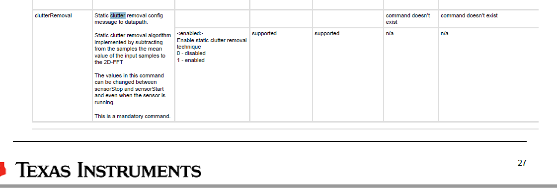

    Another possiblity is to use the clutter removal function available in SDK 1.1.  Note that it will work only if the radar and the clutter is stationary, and the targets are moving. I've snipped the relevant portions and added them below.
