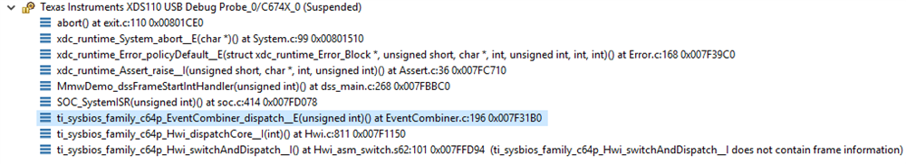

I am using an IWR1642 EVM as an I2C slave to send data to a master Arduino controller.
Using the I2C driver and the Slave test provided in the SDK, I was able to make the IWR slave write data to the bus, and the data was received on the Arduino side.
However, when I call the same write function,
I2CSlave_write(I2CSlave_Handle handle, const void *buffer, size_t size)
on the MSS core during the execution of the mmwave demo, I get a failure in the DSS core.
Here is the error on console output:
{module#8}: "../dss_main.c", line 264: error {id:0x10000, args:[0x8139b4, 0x8139b4]}
xdc.runtime.Error.raise: terminating execution
This is the line:
    /* Check if previous chirp processing has completed */
    DebugP_assert(gMmwDssMCB.dataPathObj.interFrameProcToken == 0);
Here is the call stack during error:
I am not sure at all why this would be happening since the i2c write function is running on a the MSS core. However, the call stack does point to something going wrong with the interrupts. Is it because when the DSS finishes processing a frame, it signals an interrupt to the MSS so MSS can receive it, but in the case of i2c, the i2c driver is blocking mode, so it makes MSS unresponsive to the interrupt originating from DSS? I will look into this further, and hopefully you can share your perspective.

  • Hello Herman,
    The exception could be very well because of the blocking nature of the I2C call and also can be attributed to the I2C interface slow speed nature.
    We will have someone in the team reproduce the scenario and send you more details ASAP.
    -Raghu
  • Yes, as mentioned by Raghu it is likely that the I2C call on the MSS is causing it to miss a handshaking interrupt from the DSS. The I2C driver can be configured to run at 400Khz - did you try that, or run at the default 100KHz? You can also try reducing the amount of data being sent in order to test that it's a timing issue. If you can't run at 400KHz and send all the data you want to send, you may be able to break the transfer into smaller pieces to work around the interrupt schedule, or perhaps try another serial interface (such as UART or SPI).
  • Thanks for your replies.
    I have placed the I2CSlave_write function into a new task and this allows the code to run for about 1-2 minutes, until the same handshaking error appears. I've played around with the task priority but without success.
    Next, the I2CSlave_write function also returns FALSE when the 7-bit addressing mode is used. (I need to use the 7-bit address mode to work with the Wire library from Arduino.) However, the write function still writes to the I2C bus and I see the data printed to the console from the Arduino.
    I have tried 400kHz mode but it doesn't seem to work. I changed the default parameters in the I2C driver of mmWave SDK and have configured the Arduino Wire library in the 400kHz mode, but with no success. I am only sending 8 bytes at a time so the bit rate should not really matter.
    Originally I wanted to look at I2C because I want to run 4 IWR slaves. If I do not get this working soon, I'll definitely look into SPI.
