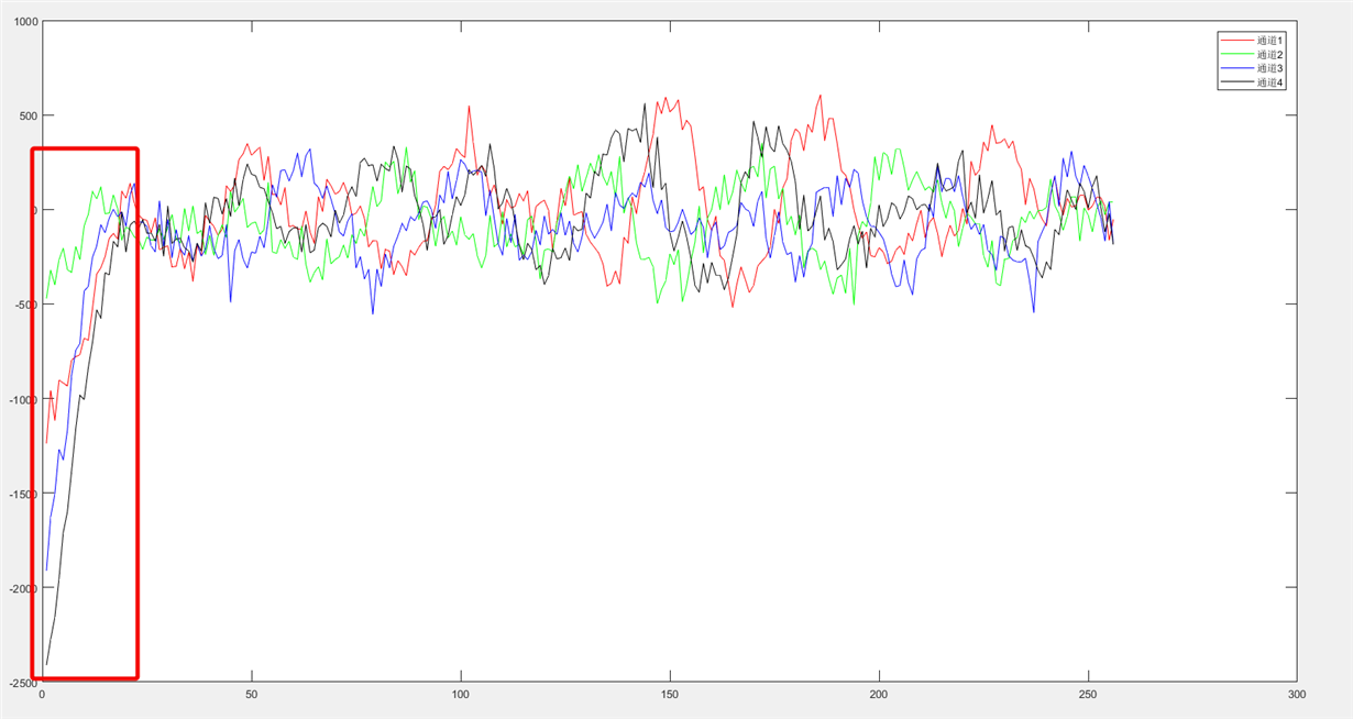

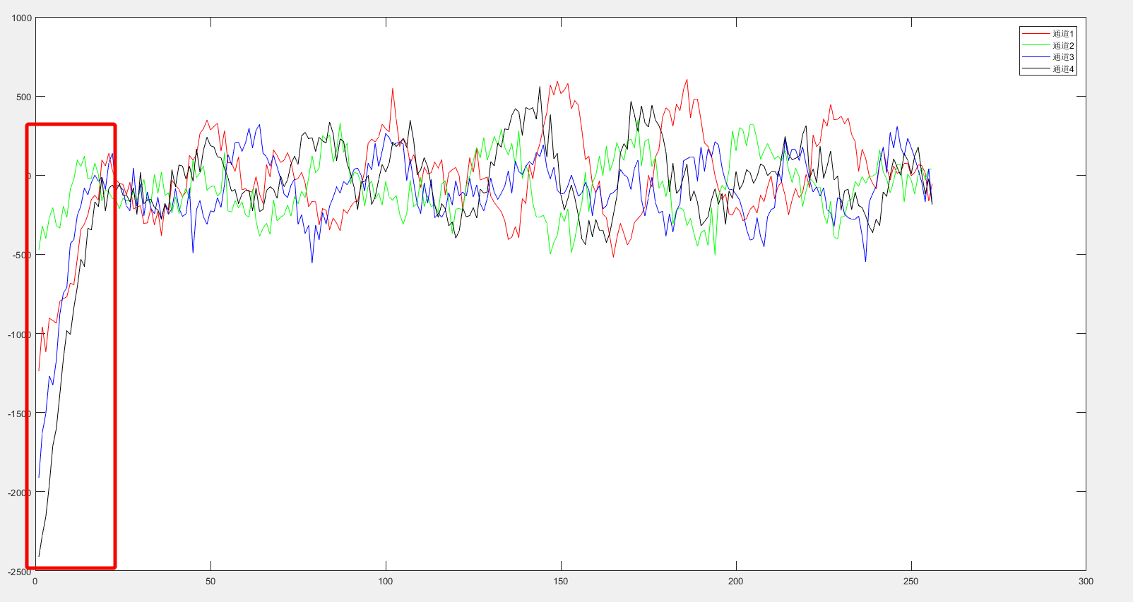

I set up a project to capture data by LVDS output, and found the head part of each chirp data has a big bias.
My configuration is profileCfg 0 77 5 5 29 0 0  9 1 256 12200 0 0 48.
What cause this? Idle time or adc start time?
Thanks!
    For the start of each chirp, there is a ADC Start time, which allows for the Digital Front End (DFE) filtering to stabilize.   In mmWave SDK 1.1, there is also a DC Bias control, which has been added (there is a newer dfp and Radar Studio package also).

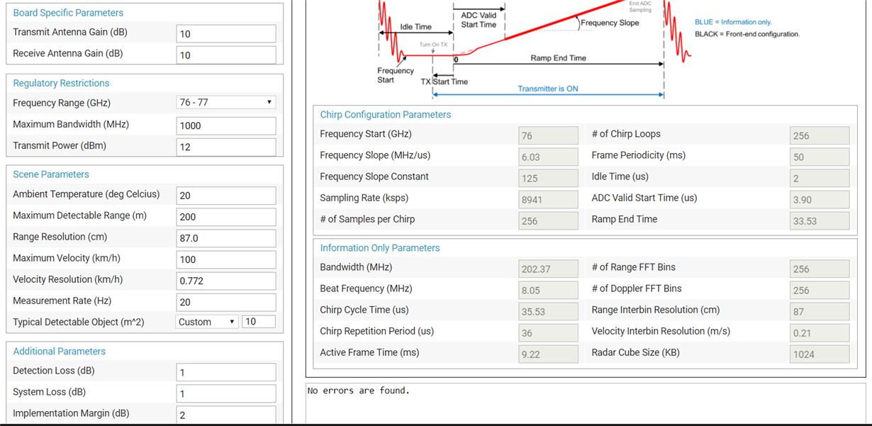

    Initially you can design your radar parameters using the mmWave System Estimator - "dev.ti.com/.../"
    You can translate the parameters calculated into the StaticConfig, DataConfig, RampTimingCalculator, and SensorConfig
    In some cases The ADC Start time is increased, not just for the 99% settling, but further increased to remove the startup transient, in your case, this would be
    the numb DFE outsamples / DFE out rate + existing ADC start time.
    There is an additional API for DC Bias removal.   I suggest you adjust the ADC Start time first.

  • Hi, Joe,
             Thank you for your information.
              I tried to set the configuration in your recommended website, and finally find out a less ADC time and idle time. I am afraid it may be worse than my setting.
