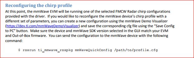

  • Hi Nitin,
    Thanks for your reply, it was helpful.
    I would like to continue using the ti_mmWave_rospkg, which has been working well. If I understood correctly, the rospackage works for the out-of-the box demo only, correct? Is it possible to configure the EVM to get longer range (such as in the traffic monitoring configuration) using the out-of-the-box demo app?
    Thanks for your help.
    Ryen
  • Hi Ryen,
    You're right, the ROS visualizer package works only with the out of the box demo. You can change the chirp profile in the ROS point cloud visualizer demo as mentioned on page 11 of the corresponding user guide (section: Reconfiguring the chirp profile) and shown in the snapshot below:
    -Nitin
