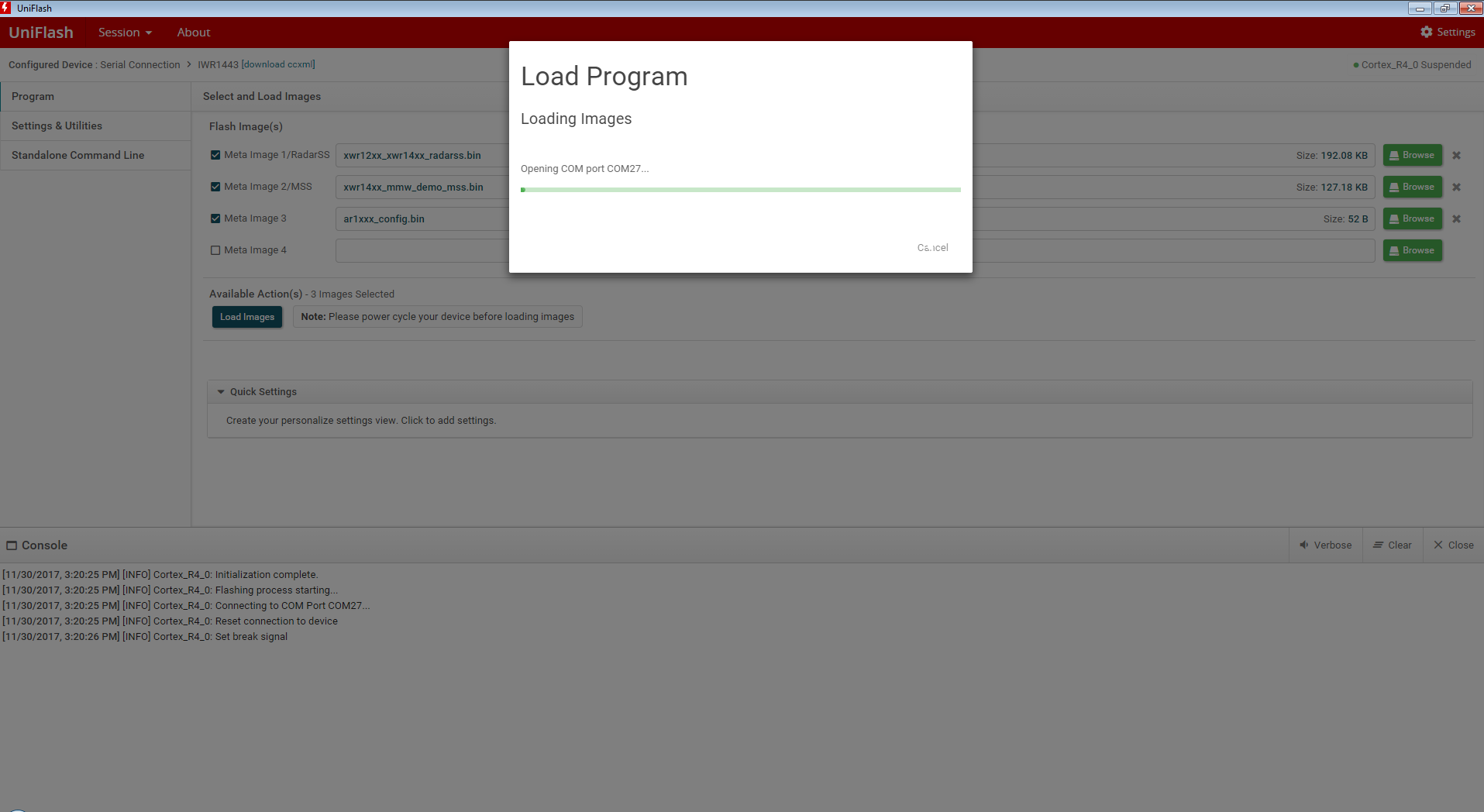

We are having trouble flashing firmware to an IWR1443 that is a component on our RADAR starter kit. Our starter kit functions the same as a TI IWR1443BOOST, however the layout is split into two boards. The baseboard has the XDS110 and the top board has a xWR1x43 chip. The top board may be interchanged to use different RADAR modules (AWR1443, IWR1443, AWR1243, IWR1243) and different antenna configurations. We are having the same problem with both IWR1443 and IWR1243 boards.
We have been using this design with no troubles up until recently. The latest batch of RADAR boards we received have not been working. Flashing firmware to the starter kit is done with Uniflash in the same way as it would be on a TI 1443BOOST, however when flashing firmware to the new boards I receive the following error.

We think it is acting like the SOP signals are not being latched by the IWR device. This is behaving fine with our older hardware. We have considered that the XDS110 firmware may need to be updated, but we cannot find newer firmware. We are currently at version 2.3.0.9.
The only change we have made to our design is the flash chip that is being used. The devices on the old hardware and TI’s EVMs are obsolete. We stayed in the same Cypress (spansion) family, however, we are larger density.  I do not believe we are getting to the point of communicating with the SPI chip though. This seems like an issue between XDS110 and IWR through the UART.
Is there a firmware update we are missing for our XDS110 chip? Is there any other way to flash the IWR1443 besides using Uniflash?

  • Thank you for the information. We were able to get the module working by rolling back the flash chip to the previous version. Unfortunately this is an obsolete part, so we will be looking for a compatible part to continue manufacturing.
