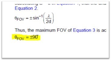

  3. Looking at the Application Report SWRA554–May 2017  (MIMO Radar) I’ve noticed that the FOV stated as +/-90DEG. I remember that:
The highest value, which can be achieved for the Field of View (FOV) of a planar phased array antenna is 120°. Shouldn’t it be +/-60?
