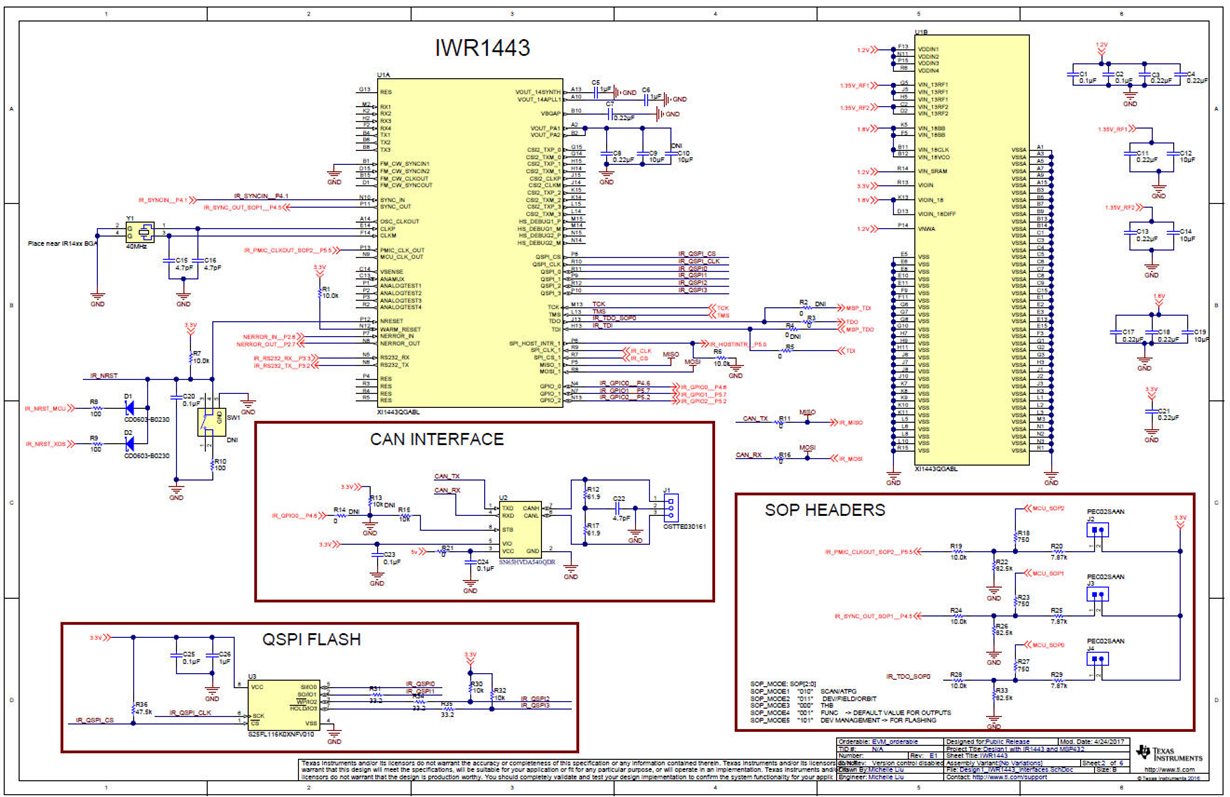

  • Do you have this IWR1443 schematic in Orcad, or DXF or DWG format to import as a starting point for our design?  It is your IWR1643BOOST board ?
    Thanks, Peter
  • Correction schematic for IWR1443BOOST
