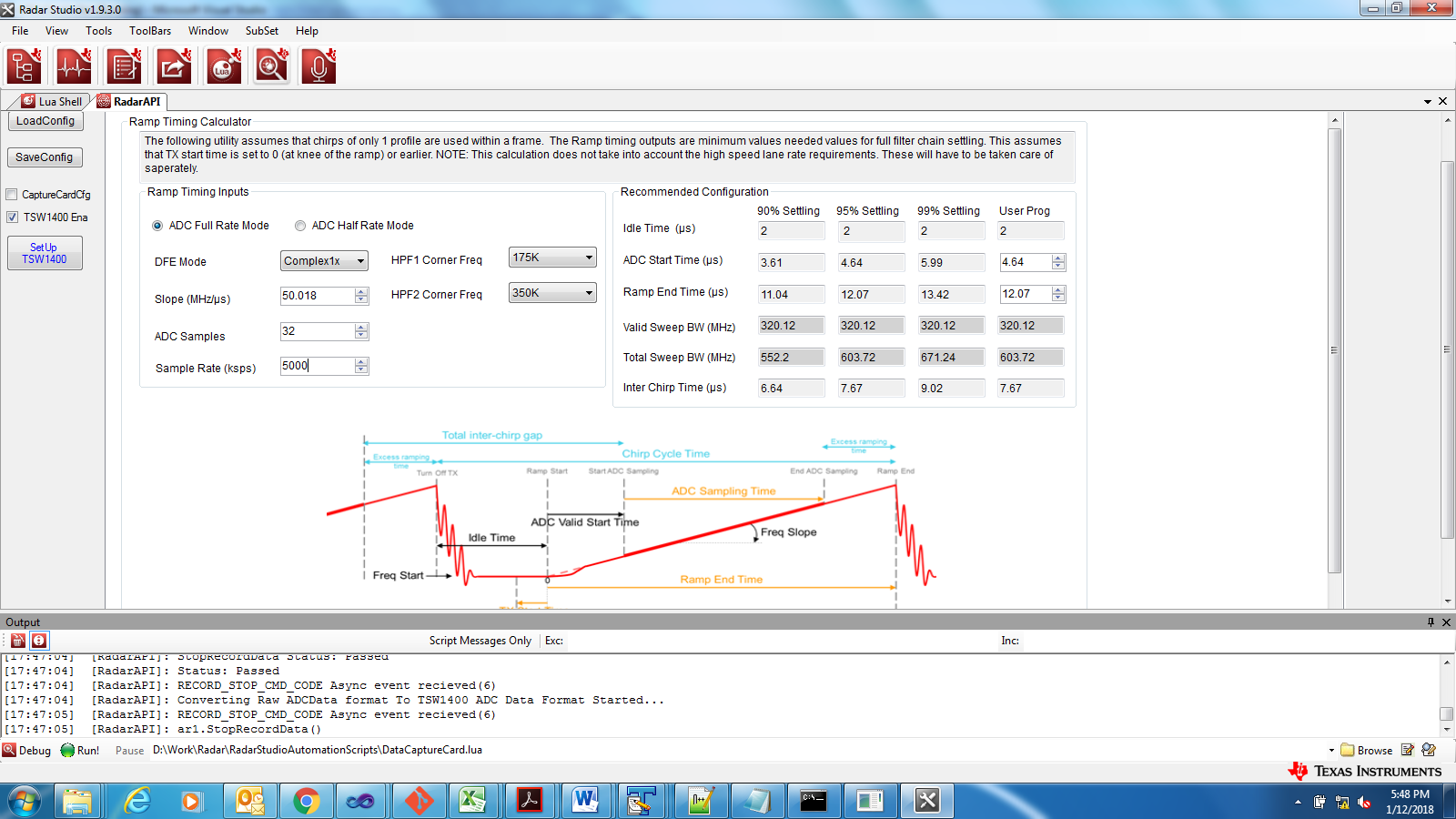

  • Anil;
    The Ramp timing calculator won't allow me to enter a number less than 64 samples.
    Erik
  • Hi Erik,
    Sorry about that. We will be (fixing) and releasing a newer version of RadarStudio soon. For the time being, I can share the following image for 32 adc samples.
    If you can share your desired slope and sampling rate, I can run the same through the updated 'ramp timing calculator' and send it to you.
