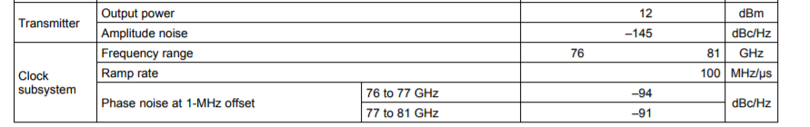

  • Hi Canan,
    AWR1642 only guarantees that the spectrum up to 90 % of the max IF frequency is  available. As per our experiments, doppler of objects at 90 % of the IF frequency can be correctly estimated.  Beyond this limit, the low pass filters (LPF) of the digital front end (DFE) attenuate the signal heavily.  Note that the IF frequency is programmable.
    The notion of an 'instantaneous spectrum' doesn't make sense to me. In order to construct a spectrum (using say an FFT) you need multiple samples over time. As for the 'leakage' specification, there are two numbers that should interest you, the first is 'amplitude noise', and the second is 'phase noise'. Both these numbers are given in the screengrab below.
