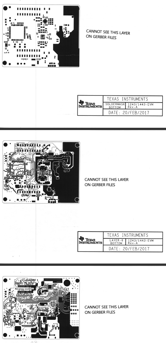

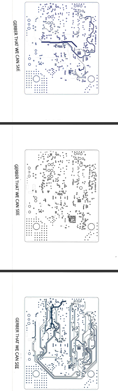

We cannot find the tricky antenna layer in the Gerbers in the ZIP files  .
We can see them on the PDF but not the Gerbers.  They seem to be missing.  Please send a link to the Gerbers for all of the layers on the IWR1443BOOST board.
Also, where can the Schematic be found in a format that can be edited so that we do not need to redraw everything?
Thanks, Peter
top is Gerber.  Bottom is PDF with similar layer but no antennas layers on the right.

    I have opened the 1443 BOOST board file, in the PCB editor and re-exported the artwork and drill files,  they are in the attached ZIP.
    There is a hardware design guide attached, it discusses the RF connections (special layer 2 hole), layer 1 Grounded Coplanar Waveguide, RF stripline and the antenna.  In your top colored picture, the etch was turned off.   The RF traces and antenna are not schematic elements, they are drawing in layout.
    The hardware design guide has the references for the GPCW, the antenna dimensions, depend on your needed antenna design.

  • We can see 4 layers but 3 layers are missing.  Our Sunstone software can do 6 layers.   Is the IWR1443BOOST a 7 layer board. ?  Are some layers turned off or do you think it is our software?
    Thanks, Peter
  • 1443_layout_122617_check.zipI have taken the 6 layers, Top, L2, L3, L4, L5, and Bottom and plotted them in Cadence PCB Designer, and imported the .art files to GC Prevue
    artwork viewer they are all present.
    I have included the .art, .gwk (gerber import to GC Prevue), and .pdf files plotted from Cadence.
    in the IWR1443BOOST_RevA layout, you have to line up the proper files.
