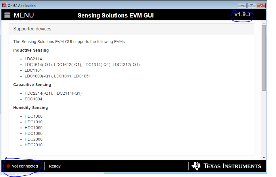

I am having a connection issue related to “ Texas Instruments - Analog Evaluation Module : LDC1612EVM.
I am connecting this EVM to my pc , on which “OneUI Application – Sensing Solutions EVM GUI v1.9.3 ” is installed . But after connecting the EVM with USB to PC ,it is not reading the device .
I have also installed “TI_MSP_430DRIVER_1.0.1.0” .Please suggest me the appropriate software or driver I should  install .Please Help.

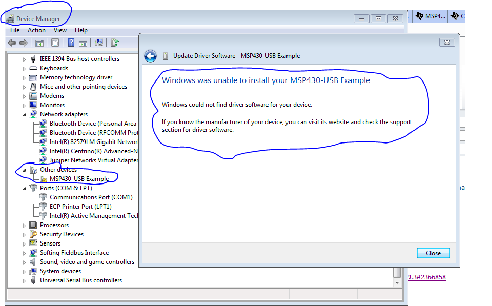

I have also manually forced my device manager to look for a driver . I am getting the following response in device manager .

    Sorry for the trouble. The EVM driver is supposed to get installed automatically however depending on the security profile on your windows machine this may not always happen.

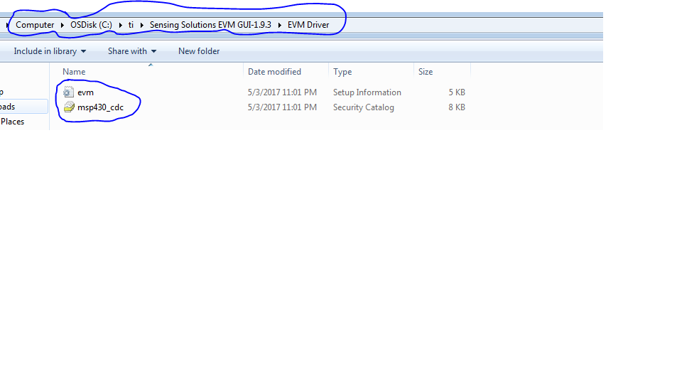

    A copy of the correct driver is located in C-> ti> Sensing Solutions EVM GUI - 1.9.3 -> EVM Driver
    Please point windows to look in this location. Let us know if you are still having troubles.

  • Hello Sir ,
    My driver folder have following files in it .
    Could you please elaborate the procedure for pointing the windows in following Location .
