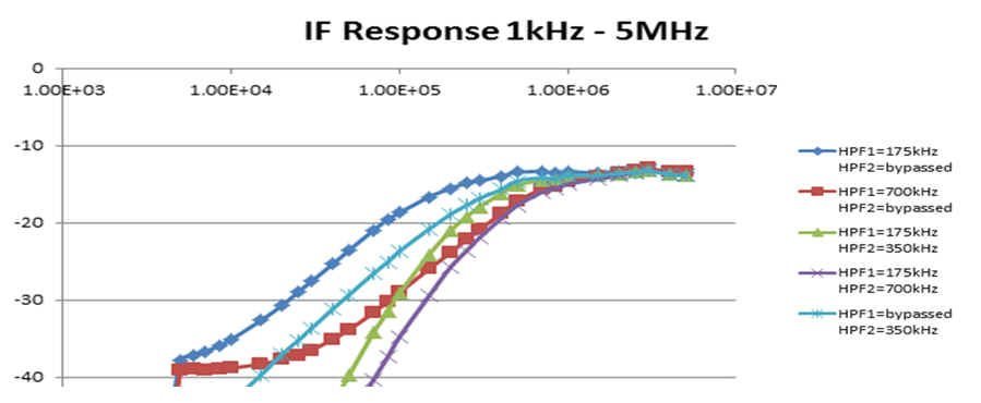

HI champion,
   In below post
https://e2e.ti.com/support/sensor/mmwave_sensors/f/1023/t/610630?tisearch=e2e-quicksearch&keymatch=HPF
  We can find a attentuation curve when HPF1/HPF2 is bypassed, but we could not find this configuraiton in radar API. In rlProfileCfg_t, we can only configure the cutting frequency of HPF1/2 to a non-zero value.
  Could we help to clarify is there a way to bypass one of the HPF?
