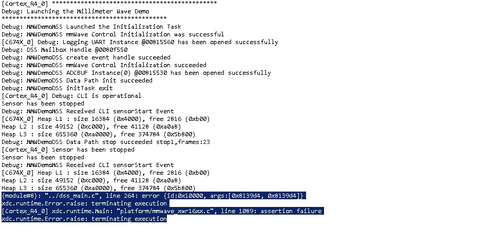

  • Dear Michelle,
    Thanks for your answer. I tried to double the baud rate, but the radar DSS will still fail for more than 3fps (It is the out-of-box demo and the "Best Velocity Resolution" and " Range Doppler Heat Map" are checked). It happened for the previous baud rate setting, where however the theoretical frame rate should be up to 5 fps.
    I pasted the error log in CCS below:
    "{module#8}: "../dss_main.c", line 264: error {id:0x10000, args:[0x8139d4, 0x8139d4]}
    xdc.runtime.Error.raise: terminating execution
    [Cortex_R4_0] xdc.runtime.Main: "platform/mmwave_xwr16xx.c", line 1089: assertion failure
    xdc.runtime.Error.raise: terminating execution"
    I checked the line 264 in dss_main.c, which is "DebugP_assert(gMmwDssMCB.dataPathObj.interFrameProcToken == 0);".
    The line checks if previous chirp processing has completed. Thus the error may comes from no enough transferring time in buffers?
    Could you run it to check if you have the same issue? And how to solve this problem?
    James
  • James,
    For doubling the baud rate, I used my own development tool to check if the output is working. For your case, it looks like you are still using visualizer. The snapshot shows the baud rate is still 921600. You might need to hack the current visualizer for higher baud rate.
    Another thing I noticed is that you selected both Range Azimuth Heat Map and Range Doppler Heat Map. We don't recommend doing that. Usually only one heat map to be selected. What's the reason you need both heat maps on?
