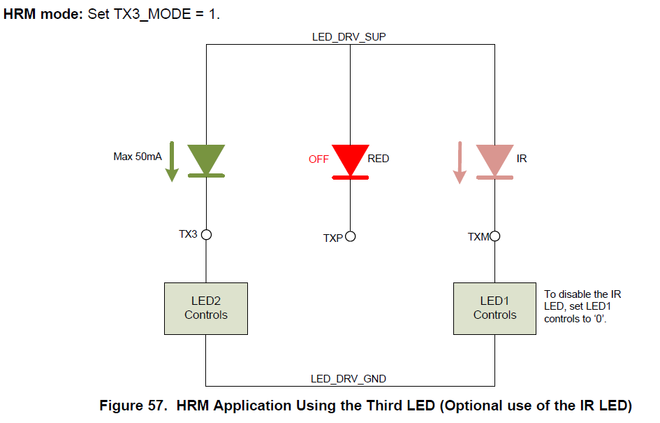

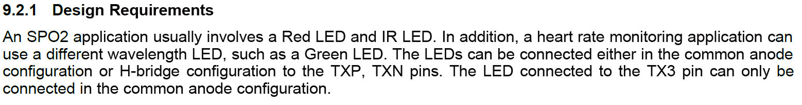

Hi, while reading the datasheet, looks like the green LED is used for measuring the heart rate. Whereas the red LED is used for measuring the SpO2 application.
I use CC3220SF-LAUNCHXL and a custom AFE4403 module that uses the SPH7050. These are my questions.
1. Is it not possible to turn on both green and red LEDs from SPH7050?
In other words, I cannot measure both the heart rate and the SpO2 at the same time?
2. Is the green LED is mandatory for HRM (Heart Rate Monitoring) application?
In the datasheet, it doesn't say that I must use the green LED for HRM.
I'm curious whether I can calculate both the heart rate and the SpO2 at the same time with a single LED (green or red, if I can only use one LED).

  • Hi David,
    As timing control signal of LED2 is shared between Green and Red LED, only one can be switched ON at a time.
    Also there is only one convert phase for Green and Red LED so it doesn't make sense to fire them simultaneously.
    Choice of Green LED for the HRM is based on some studies that suggest that Green wavelength is not effected by the skin factors. As for AFE4403 is considered, we don't have any restriction, it completely depends on the application as well as the post processing involved.

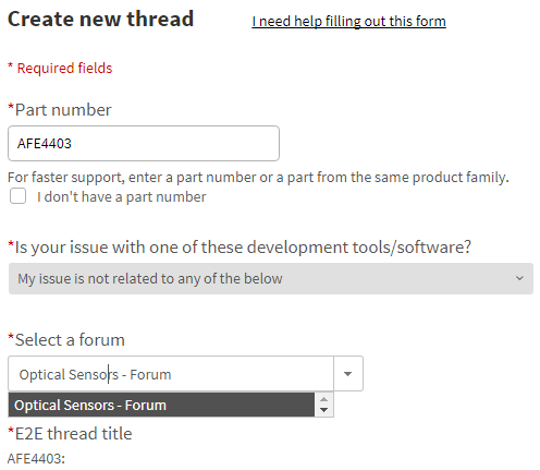

    I see. I tried to ask this in the TI's Medical Forum.
    However, when I type AFE4403 in the "Part number" blank, the question is automatically posted at TI's Optical Forum and I can only choose the Optical Forum.
    Then can you help me to post a question about the algorithm when using the Green LED? I hope the Medical Forum team can help me.

  • Hi David,
    Let me check if I can move this post to Medical forum.

  • Thanks, Prabin. I think this thread can be closed due to your hard work.
    Can you leave me an answer here whether it is possible to post questions to the Medical forum to ask about the HRM algorithm with the green LED?
