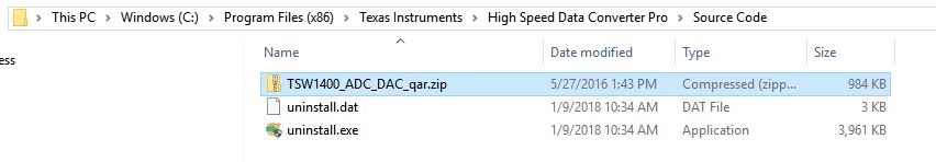

Please provide the FPGA code to interface the AFE5809 LVDS interface.
Subash,

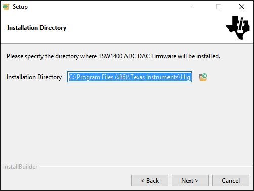

I verified the installation and the default installation directory is C:\Program Files (x86)\Texas Instruments\High Speed Data Converter Pro
The executable creates a 'Source Code' directory and the FPGA code will be located here.
Please run the exe in administrator mode and also check if your firewall or AVS is not interrupting the installation.
