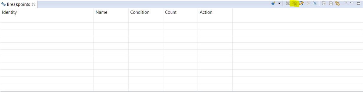

Using capture demo have a problem with AWR1642, I connect target and load, but Cortex_R4_0 is not work well, here is the message:
Cortex_R4_0: Trouble Removing Breakpoint with the Action "Process CIO" at 0x17e42: (Error -1066 @ 0x17E42) Unable to set/clear requested breakpoint. Verify that the breakpoint address is in valid memory. (Emulation package 7.0.48.0)
But I clear all breakpoint in mss.c, can you help me?

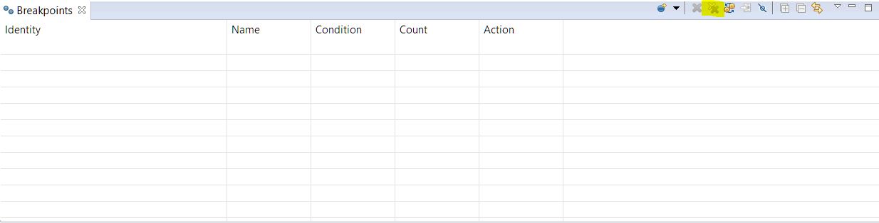

  • Hello Jian,
    Have you tried removing all the breakpoints as below:
    Go to "View->Breakpoints-> Remove all breakpoints"
    You need to do this selecting "Cortex_R4_0" and "C674x_0" separately.
    Please let us know if you still face same problem even after following this step to remove the breakpoints.
    Raghu
  • Hi, Raghu
    Thank you for your reply, the breakpoints problem is resolved by removing all the breakpoints. Thanks!
