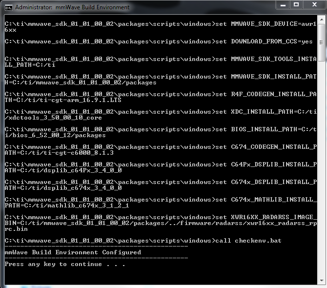

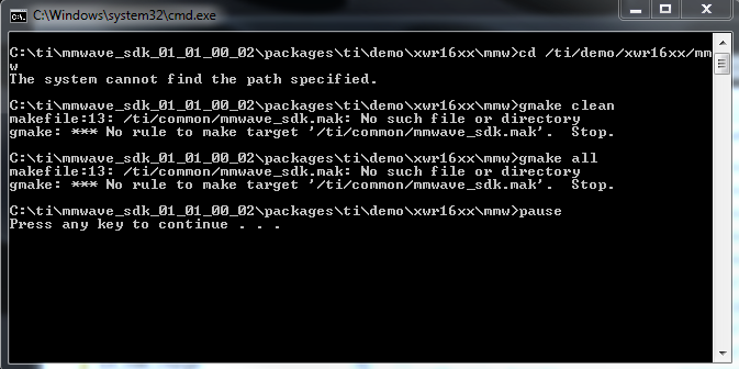

  • A1:
    I reinstalled the SDK and reran the setenv file. I still get the same results when trying to build the projects through batch files calling the make. Anytime the makefile uses a path reference $(MMWAVE_SDK_INSTALL_PATH) it does't get interpreted.
    "makefile:13: /ti/common/mmwave_sdk.mak: No such file or directory" You can see here the path reference doesn't even show up.
    I will look into your answer for A2.

  • sentenv.bat in C:\ti\mmwave_sdk_01_01_00_02\packages\scripts\windows
    @REM ###############################################################################
    @REM #
    @REM # Set up tools and build environment variables for mmwave sdk
    @REM #
    @REM # Build variables (to be modified based on build need)
    @REM Select your device. Options (case sensitive) are: awr14xx, iwr14xx, awr16xx, iwr16xx
    set MMWAVE_SDK_DEVICE=awr16xx
    @REM If download via CCS is needed, set below define to yes else no
    @REM   yes: Out file created can be loaded using CCS.
    @REM        Binary file created can be used to flash
    @REM   no:  Out file created cannot be loaded using CCS.
    @REM        (additional features: write-protect of TCMA, etc)
    set DOWNLOAD_FROM_CCS=yes
    @REM # Customer installed tools variables (to be modified based on the installation)
    @REM # TI tools variables (no changes needed below this line if default mmwave sdk
    @REM # installation options are used)
    set MMWAVE_SDK_TOOLS_INSTALL_PATH=C:/ti
    @REM Common settings for awr14xx, awr16xx, iwr14xx, iwr16xx
    @REM Path to <mmwave_sdk installation path>/packages folder
    set MMWAVE_SDK_INSTALL_PATH=%MMWAVE_SDK_TOOLS_INSTALL_PATH%/mmwave_sdk_01_01_00_02/packages
    @REM TI ARM compiler
    set R4F_CODEGEN_INSTALL_PATH=%MMWAVE_SDK_TOOLS_INSTALL_PATH%/ti-cgt-arm_16.9.1.LTS
    @REM TI XDC TOOLS
    set XDC_INSTALL_PATH=%MMWAVE_SDK_TOOLS_INSTALL_PATH%/xdctools_3_50_00_10_core
    @REM TI BIOS
    set BIOS_INSTALL_PATH=%MMWAVE_SDK_TOOLS_INSTALL_PATH%/bios_6_52_00_12/packages
    @REM Following only needed for awr16xx and iwr16xx
    @REM TI DSP compiler
    set C674_CODEGEN_INSTALL_PATH=%MMWAVE_SDK_TOOLS_INSTALL_PATH%/ti-cgt-c6000_8.1.3
    @REM DSPlib
    set C64Px_DSPLIB_INSTALL_PATH=%MMWAVE_SDK_TOOLS_INSTALL_PATH%/dsplib_c64Px_3_4_0_0
    @REM DSPlib C674
    set C674x_DSPLIB_INSTALL_PATH=%MMWAVE_SDK_TOOLS_INSTALL_PATH%/dsplib_c674x_3_4_0_0
    @REM MATHlib
    set C674x_MATHLIB_INSTALL_PATH=%MMWAVE_SDK_TOOLS_INSTALL_PATH%/mathlib_c674x_3_1_2_1
    @REM awr16xx/iwr16xx radarss firmware. Use the RPRC formatted binary file.
    set XWR16XX_RADARSS_IMAGE_BIN=%MMWAVE_SDK_INSTALL_PATH%/../firmware/radarss/xwr16xx_radarss_rprc.bin
    @REM Call script to check env variables and set paths
    call checkenv.bat
    @REM Check error code
    IF %ERRORLEVEL% NEQ 0 (
      REM ERROR: Failure in checkenv.bat !!!
      REM Return error
      EXIT /B 1
    EXIT /B 0
    make.bat in C:\ti\mmwave_sdk_01_01_00_02\packages\ti\demo\xwr16xx\mmw
    cd %MMWAVE_SDK_INSTALL_PATH%/ti/demo/xwr16xx/mmw
    gmake clean
    gmake all
    pause

  • Hello Eric,
    Do you get the same error if you try without using your make.bat for the build ?
    -Raghu

    Can you elaborate on trying to build without the bat? Do you mean via manual command prompt or through CCS? I can tell you that through CCS works.
  • Hello Eric,
    It looks like you are not executing the make.bat in the same command window you used for setenv.bat. Please confirm where you execute make.bat.
    I meant via manual command prompt in the same command window where you set the environment variables.
    -Raghu
  • Ahh yes, that was the issue. I didn't realize the PATHs were local to the command prompt and the verbage made me think two bats was ok.
    I think every one of my questions has been answered. I haven't gone through the entire process, but I'll mark one of the replies as 'answer'.
