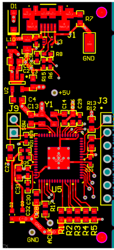

The EVM was accidentally unplugged while updating the firmware and is now bricked. The FAQ page for inductive sensing said “re-flash the EVM as described in the user guide by connecting the PUR pin to VUSB. This can be done on the LDC1612 rev B EVM by connecting R2 to C29 as shown below”, but this does not look like the right.
FAQ Page Layout:
LDC1612 User Guide’s Rev. B Layout:

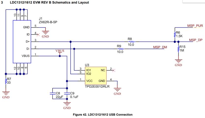

Looking at the schematic for the EVM, should the connection actually be from R6 to C8/C9?
