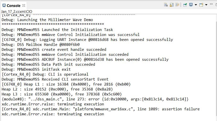

    I follow the solution you suggested above but I still encounter some failure!
    Could you tell me how to set the frame rate to 0.25 Hz?
    Because when i tried to set Frame periodicity = 4000 ms to achieve 0.25 Hz frame rate as suggested, it always generated some configuration errors! I discover that in both the visualizer and the Radar mmwave_calculation, the lowest allowable value of Frame rate is 1Hz, so I just wonder how you can do that?
    When I set the frame rate equal to or higher than 1Hz, then some time issues are raised due to the long time it takes to transfer 1D FFT to output?
    I also tried to adjust some variable like loop number and Idle time but it seems doesnt help! I set idle time up to 1000 usec and loop number down to 16. If I set idle time above this value then I encounter some configuration error again!
    Could you suggest me some solution for this?
    Thanks!
    Taiga

    Apologies. I just realized that the slowest framerate is ~1Hz, and it seems as though the UART data rate isn't sufficient to transfer the radarcube in 1Hz. Could you share the exact error you are seeing when you set the frame rate to 1Hz?
    My suggestion would be to reduce the size of the radarcube.

  • Dear Anil,
    Thanks for your answer, your configuration works well. But could you show me how calculated the time to choose this configuration.
    By the way, here is the error when i set frame rate = 0.25, equivalent with frame periodicity = 4000 ms.
    Taiga
