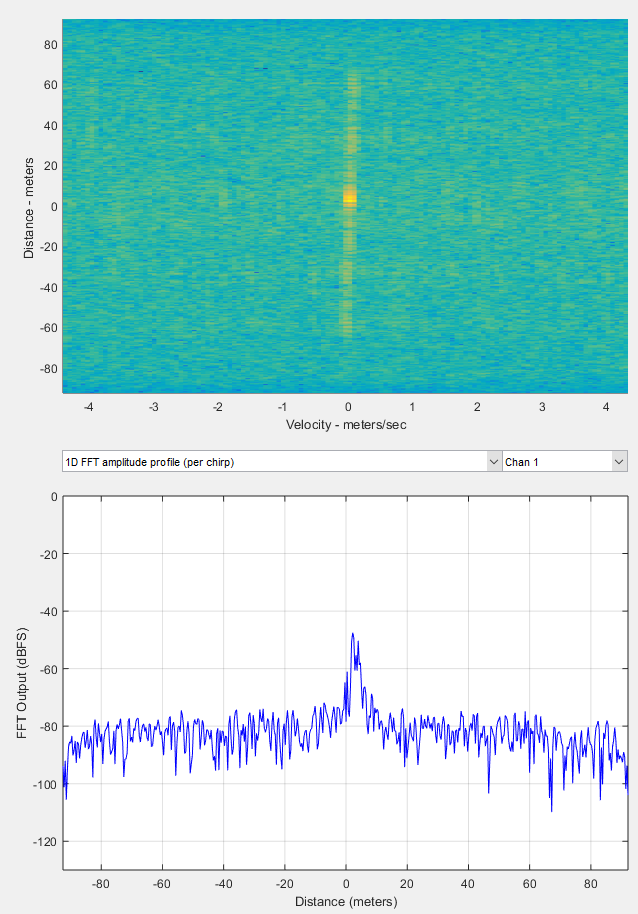

3) And a more basic question... what is it that I see in the picture below. Where does the consecutive spikes come from? They seem to change in frequency spacing when i change the ADC samples/sample rate. (I get a more familiar picture in the PostProc (in radar studio) below.)
/Henric

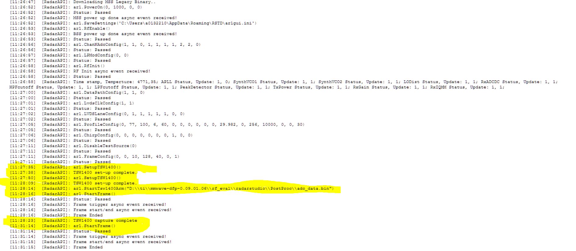

    I am attaching the RadarStudio Output log and highlighted the "TSWsetup" and "TSW Arm" log messages, please confirm if you see the same in your output log as well.

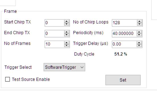

    Could you also confirm the number of frames you have set in the frame configuration? The number of frames cannot be infinite in case of using the TSW1400. Please select low number say 10

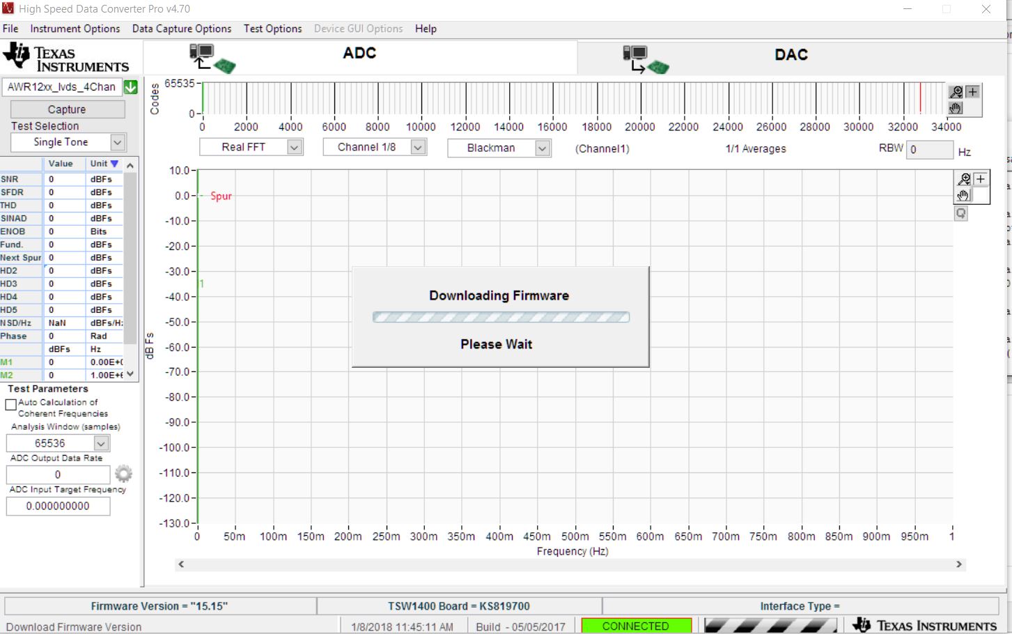

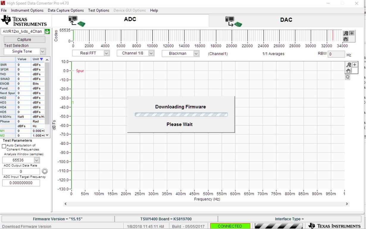

    Do you see the firmware download happening to the TSW1400 when you press "SetUp TSW1400" on the RadarStudio? Please see the below snapshot of the firmware download that happens

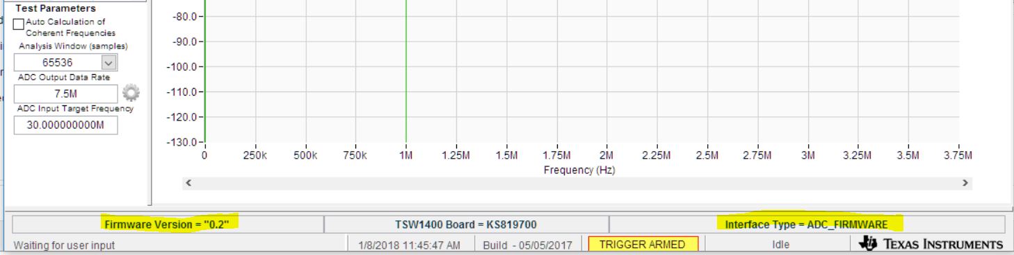

    Once the firmware download is successful, you should see the "Interface Type " and the "Firmware Version " updated as below :
    If these steps are successful, then the ADC capture on the HSDC Pro should happen when you press "Trigger Frame " on the RadarStudio and the adc.bin should be having the data. You do not need to seperately read the DDR memory to fill the adc.bin file.

    I've set the frame=10 as in your picture. I do not see the dowload window when I press "SetUp TSW1400", however I can see "Interface Type " and the "Firmware Version " updated exactly as in your picture.

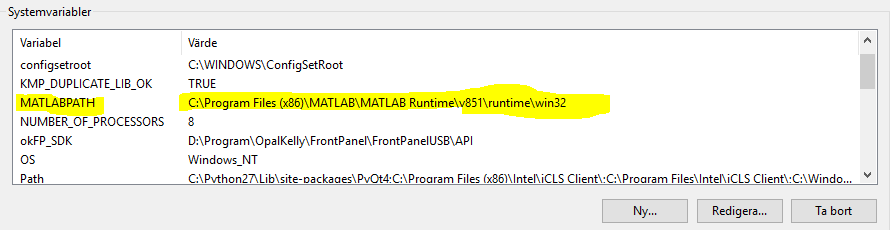

    I'm not getting the exact same respons as you are. Something wrong with Matlab? (I've dowloaded the Matlab runtime as instructed, however I also have a Matlab license installed on my computer as in the picture )
    [21:03:34]  [RadarAPI]: Status: Passed
    [21:03:41]  [RadarAPI]: ar1.Connect(5,115200,1000)
    [21:03:43]  [RadarAPI]: Error: Connection failed: Calling_ConnectTarget returned 3
    [21:03:43]  [RadarAPI]: ar1.Calling_IsConnected()
    [21:03:43]  [RadarAPI]: ar1.SaveSettings('C:\Users\Henric\AppData\Roaming\RSTD\ar1gui.ini')
    [21:04:19]  [RadarAPI]: ar1.Connect(10,115200,1000)
    [21:04:20]  [RadarAPI]: ar1.Calling_IsConnected()
    [21:04:21]  [RadarAPI]: ar1.SelectChipVersion("XWR1243")
    [21:04:21]  [RadarAPI]: Status: Passed
    [21:04:22]  [RadarAPI]: ar1.SelectChipVersion("XWR1243")
    [21:04:22]  [RadarAPI]: Status: Passed
    [21:04:22]  [RadarAPI]: ar1.SaveSettings('C:\Users\Henric\AppData\Roaming\RSTD\ar1gui.ini')
    [21:04:25]  [RadarAPI]: ar1.DownloadBSSFw("C:\\ti\\mmwave_dfp_00_09_01_06\\rf_eval\\rf_eval_firmware\\radarss\\xwr12xx_xwr14xx_radarss.bin")
    [21:04:26]  [RadarAPI]: Downloading BSS ROM Legacy Binary..
    [21:05:07]  [RadarAPI]: ar1.DownloadMSSFw("C:\\ti\\mmwave_dfp_00_09_01_06\\rf_eval\\rf_eval_firmware\\masterss\\xwr12xx_xwr14xx_masterss.bin")
    [21:05:07]  [RadarAPI]: Downloading MSS Legacy Binary..
    [21:06:22]  [RadarAPI]: ar1.PowerOn(0, 1000, 0, 0)
    [21:06:22]  [RadarAPI]: Status: Passed
    [21:06:22]  [RadarAPI]: MSS power up done async event received!
    [21:06:22]  [RadarAPI]: ar1.SaveSettings('C:\Users\Henric\AppData\Roaming\RSTD\ar1gui.ini')
    [21:06:25]  [RadarAPI]: ar1.RfEnable()
    [21:06:25]  [RadarAPI]: BSS power up done async event received!
    [21:06:25]  [RadarAPI]: Status: Passed
    [21:11:44]  [RadarAPI]: ar1.ChanNAdcConfig(1, 0, 0, 1, 0, 0, 0, 2, 2, 0)
    [21:11:45]  [RadarAPI]: Status: Passed
    [21:13:19]  [RadarAPI]: ar1.LPModConfig(0, 0)
    [21:13:19]  [RadarAPI]: Status: Passed
    [21:13:21]  [RadarAPI]: ar1.RfInit()
    [21:13:21]  [RadarAPI]: RF Init async event received!
    [21:13:21]  [RadarAPI]: Status: Passed
    [21:13:21]  [RadarAPI]: Time stamp, Temperture: 415910,37; APLL Status, Update: 1, 0; SynthVCO1 Status, Update: 1, 1; SynthVCO2 Status, Update: 1, 1; LODist Status, Update: 1, 1; RxADCDC Status, Update: 1, 1; HPFcutoff Status, Update: 1, 1; LPFcutoff Status, Update: 1, 1; PeakDetector Status, Update: 1, 1; TxPower Status, Update: 1, 1; RxGain Status, Update: 1, 1; RxIQMM Status, Update: 1, 1;
    [21:13:52]  [RadarAPI]: ar1.DataPathConfig(1, 1, 0)
    [21:13:52]  [RadarAPI]: Status: Passed
    [21:13:56]  [RadarAPI]: ar1.LvdsClkConfig(1, 1)
    [21:13:56]  [RadarAPI]: Status: Passed
    [21:14:00]  [RadarAPI]: ar1.LVDSLaneConfig(0, 1, 0, 0, 0, 1, 0, 0)
    [21:14:00]  [RadarAPI]: Status: Passed
    [21:14:14]  [RadarAPI]: ar1.ProfileConfig(0, 77, 100, 6, 60, 0, 0, 0, 0, 0, 0, 29,982, 0, 256, 10000, 0, 0, 30)
    [21:14:15]  [RadarAPI]: Status: Passed
    [21:14:17]  [RadarAPI]: ar1.ChirpConfig(0, 0, 0, 0, 0, 0, 0, 1, 0, 0)
    [21:14:17]  [RadarAPI]: Status: Passed
    [21:14:36]  [RadarAPI]: ar1.DisableTestSource(0)
    [21:14:36]  [RadarAPI]: Status: Passed
    [21:14:36]  [RadarAPI]: ar1.FrameConfig(0, 0, 10, 128, 40, 0, 1)
    [21:16:24]  [RadarAPI]: ar1.SetupTSW1400()
    [21:16:27]  [RadarAPI]: TSW1400 set-up complete.
    [21:16:55]  [RadarAPI]: ar1.StartTsw1400Arm("D:\\adc_data.bin")
    [21:17:05]  [RadarAPI]: MatlabProc Status: Error Type: No Data was collected. Please check.
    [21:17:05]  [RadarAPI]: TSW1400 capture complete
    [21:18:05]  [RadarAPI]: ar1.StartFrame()
    [21:18:05]  [RadarAPI]: Status: Passed
    [21:18:05]  [RadarAPI]: Frame trigger async event received!
    [21:18:06]  [RadarAPI]: Frame start/end async event received!
    [21:18:06]  [RadarAPI]: Frame Ended
    [21:23:47]  [RadarAPI]: ar1.StartMatlabPostProc("D:\\adc_data.bin")
  • The Env-var is obviously for the run-time version. Noticed that my comment could be interpreted as for the full Matlab...
