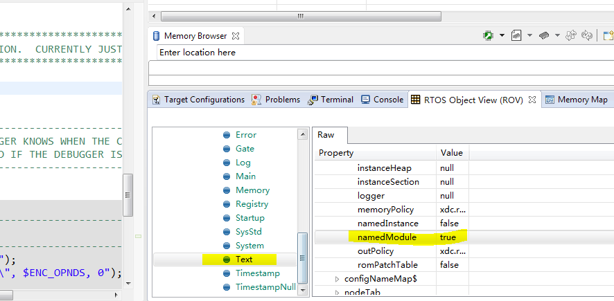

  • Are you sure you rebuild the .cfg file? Can you look ROV at the below settings and confirm this on the target?
    Note: you should not be passing in a NULL Error_Block into the create calls. Take a look an example/docs to see how to use Error_Block. Basically you need to initialize an Error_Block and pass it into the create call. The Error_Block can be used as an advanced debug feature.
    Can you attach your .cfg file?
    Todd

  • hello,
    I create a Error_Block,how do I see its information?
  • Set
    Text.isLoaded = true;
    The last statement in your .cfg is setting it to false. This is wiping out the previous setting.
  • I have set the last statement in your .cfg to false. but debugging is still error!
  • Set it to true!
  • the Console displaying:[C674X_0] The myEvent set up successful!
    ti.sysbios.knl.Semaphore: line 78: assertion failure: A_noEvents: The Event.supportsEvents flag is disabled.
    xdc.runtime.Error.raise: terminating execution
  • Please set the following in the .cfg file
    Semaphore.supportsEvents = true;
  • After I set it true,the console displaying:
  • I thanks very much! I debug successful!
