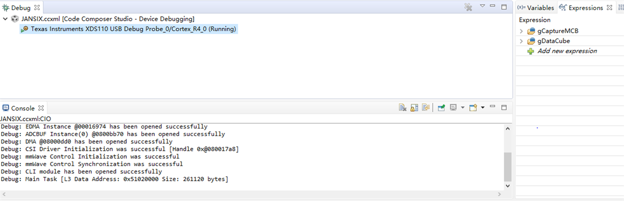

2. I have connected the IWR1443 with the CCS in the debug mode and run the capture demo .xer4f as instructed in the user guide.

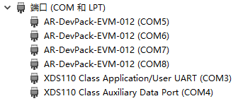

3. I have installed the USB port drivers that the dev-pack needs and the 4 COM ports can be found in the devices of PC.

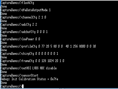

4. I have followed the instructions in the user guide and successfully sent the CLI commands.
May I know what the next step is? The user guide ended there.
If I was supposed to read the data using Tera Term with COM5 or COM6 here, may I know the configuration for the port? like the baud rate and so on.

    You should be able to see that data over the Auxiliary Data Port over Tera Term. Try connecting to the Data Port in Tera Term and setting the baud rate to 115200. All other settings can be left as default. After sending the config over the UART port you should start to see data on the data port.
