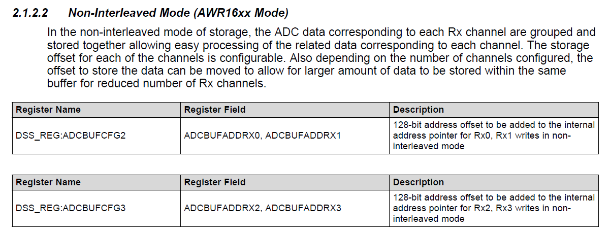

    Thanks for the help. One more question:
    In "AWR1xxx Data Path" document, the starting address of 4 ADCs are pointed by register DSS_REG:ADCBUFCFG2 and DSS_REG:ADCBUFCFG3. Where do I find the registers? I tried Register tab in CSS, but no matching register found.
  • Hi Thomas,
    You can find a list of all registers in the 1642 TRM.
    You can find the register you are looking for on page 499.
