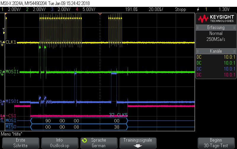

i try to read the TIME 1 register with the modified example function from TDC7200_basic_spi_rw: uint32_t TI_TDC720x_SPILongReadReg(uint8_t addr).
the result of this is that the clock stay low after each bit shift command:
after that i try to comment out the bit shift operations after each y buffer receive and all while(!(UCB0IFG & UCTXIFG)); loops. Now i get a what i want a 32 clk cycle whithout any breaks:
My Question is: Is it possible to read my TIME register and the other only read registers with this function and if its possible how i solve it?
and how can I use this function with the autoincrement bit?
thanks in advance
greets Ben

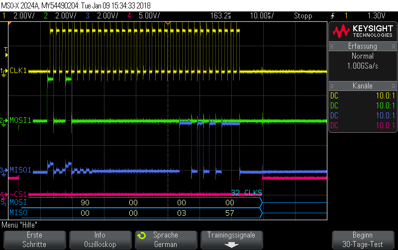

  • Hi Scott,
    thanks for reply I try this example Function but i don't use the pointer *buffer in my readout. But this experiment was not really succesful.
    Because I read the RXBUF directly in an array i lost always the last byte from the Calibration2 register. the Array get the Values everytime after the next SPI read sequence.
    My first Question is why they dont read the RXBUF immediately in my array?
    The second Question is: If i do not use the pointer like you, do i get a delay in my Function SPI_read_all. Because my application must run on the fastest way.

  • now i test a function which read one register 32 bit (see code below).
    in uint32_t SPI_read_longbyte i have the same problem as the function SPI_readall_Reg.
    The last byte from the register get lost in the variable y but on the Oscilloscope i see the last received byte.
    why the last byte get lost in my functions??it is timing problem ??
    thanks for any reply.
