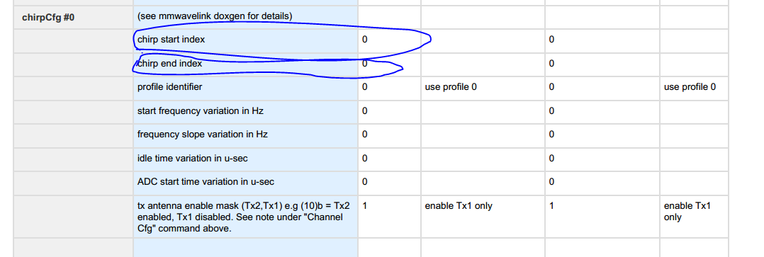

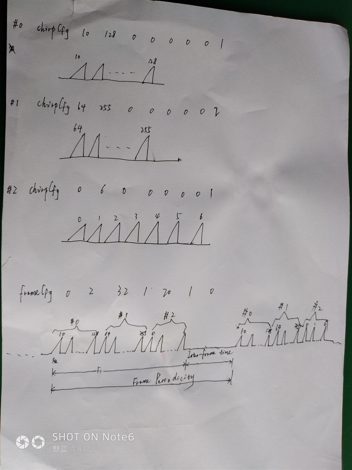

I want to ask what do chirpCfg #0 and chirpCfg #1( chirp start index  and chirp end index)repesent ?Also what  does  frameCfg( chirp start index (0-511)  and chirp end index (chirp start index-511))repesent ? I do not quite understand,As follows:
If this parameter is as follows:
chirpCfg 10 128 0 0 0 0 0 1
chirpCfg 64 255 0 0 0 0 0 1
frameCfg 32 511 128 1 20 1 0
Can you explain it in a picture way?
Thanks!
