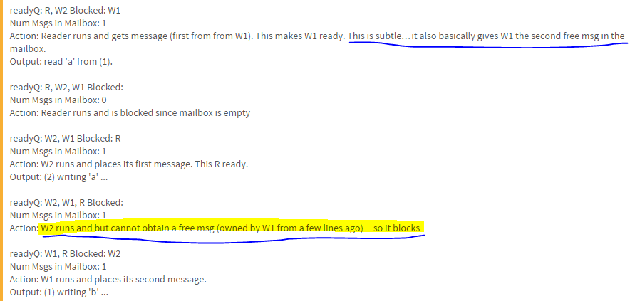

The  debugging outcomes in the console as follows:
[C674X_0] (0) writing 'a' ...
(0) writing 'b' ...
read 'a' from (0).
read 'b' from (0).
(0) writing 'c' ...
writer (0) done.
(1) writing 'a' ...
read 'c' from (0).
read 'a' from (1).
(2) writing 'a' ...
(1) writing 'b' ...
read 'a' from (2).
read 'b' from (1).
(2) writing 'b' ...
(1) writing 'c' ...
writer (1) done.
read 'b' from (2).
read 'c' from (1).
(2) writing 'c' ...
writer (2) done.
read 'c' from (2).
But I think the outcomes should be as follows:

    The actual output is correct (and expected), but it's rather tricky since all the tasks are the same priority. Note: a Mailbox instance has a Data and Free Queue. The free queue is populated with the # of msgs specified in the create. The queues are protected by Data and Free semaphores.
    Before BIOS_start here are the tasks in the ready queue for priority 2 (looking in ROV->Task->ReadyQ is very helpful!)
    readyQ: R, W0, W1, W2 Blocked: none
    Num Msgs in Mailbox: 0
    Action: BIOS_start is called, so R runs first and then immediately blocks since the Mailbox is empty.

    Action: Reader runs and gets message (last from W0). This makes W2 ready (so it will take the first free msg in the mailbox)
    Output: read 'c' from (0).
    readyQ: R, W2 Blocked: W1
    Num Msgs in Mailbox: 1
    Action: Reader runs and gets message (first from from W1). This makes W1 ready. This is subtle…it also basically gives W1 the second free msg in the mailbox.
    Output: read 'a' from (1).
    readyQ: R, W2, W1 Blocked:
    Action: Reader runs and is blocked since mailbox is empty
    readyQ: W2, W1 Blocked: R
    Action: W2 runs and places its first message. This R ready.
    Output: (2) writing 'a' ...
    readyQ: W2, W1, R Blocked:
    Action: W2 runs and but cannot obtain a free msg (owned by W1 from a few lines ago)…so it blocks
    readyQ: W1, R Blocked: W2
    Action: W1 runs and places its second message.
    Output: (1) writing 'b' ...
    Num Msgs in Mailbox: 2
    Action: W1 runs and blocks since there are no free msgs
    readyQ: R Blocked: W2, W1
    Action: R gets a message and this makes W2 ready
    Output: read 'a' from (2).
    Action: R gets a message and this makes W1 ready (and basically gives it the second free msg in the mailbox)
    Output: read 'b' from (1)
    Action: R blocks since there are no msgs
    Action: W2 runs … left to the reader to complete…

  • Sorry,I don't understand the underline place in the following picture,why?I think W2 runs and it doesn't block. Thanks very much!
  • Since the mailbox was created with 2 msgs, when it is empty, the 2 msgs are on the free queue. The semaphore (call it free-semaphore) used to manage the free queue has a count of 2 (zero denotes not available). Here are the two critical steps from above (I wished I had numbered them!). I've added some more description
    Free -semaphore count: 0
    Action: Reader runs and gets message (last from W0). This makes W2 ready (so it will take the first free msg in the mailbox).
    More detail: When the reader gets the msg via Mailbox_pend, it places the msg back on the free queue. It also sees that W2 is pending on the free semaphore. So it makes W2 ready and does not increment the free-semaphore count. Remember that W1 is on the free-semaphore pending queue also. Since W2 was made ready, W1 is now at the front on the free-semaphore pending queue.
    Free-semaphore count: 0
    More detail: Again, when R gets the msg, the internal msg that had the data is now put on the free queue. Since there is a task (W1) on the free-semaphore pending queue, it is made ready. The free-semaphore count is still zero (since both W2 and W1 obtained it and there are no more free msgs).
    Later when W2 tries to get another msgs, it blocks since there are no more free message (one is on the data queue and the other is owned by W1).
    Todd
