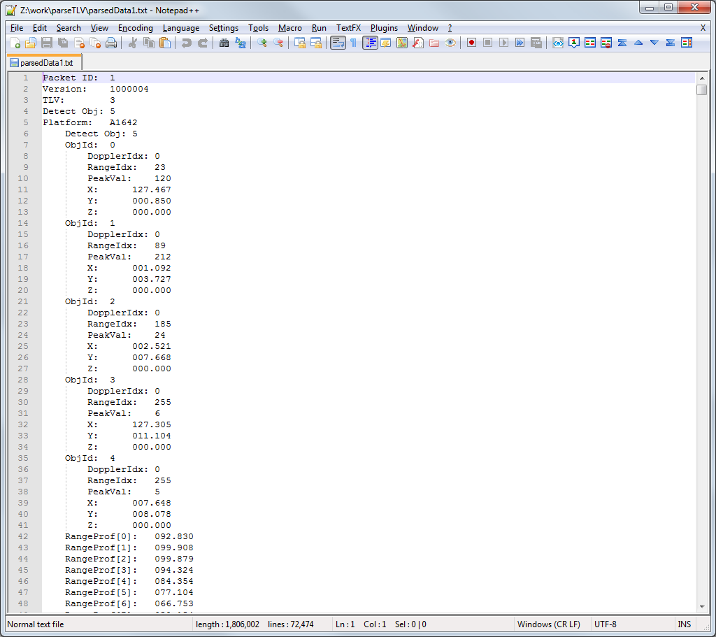

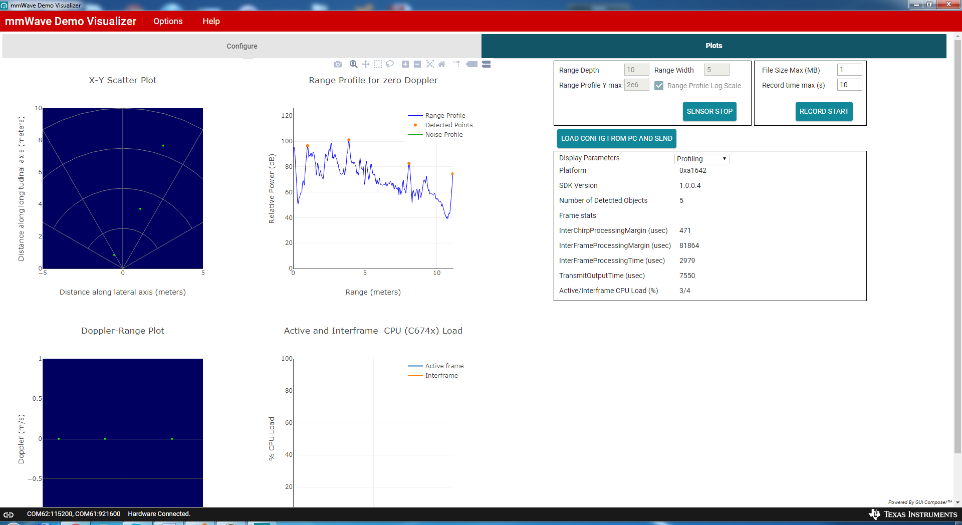

I have AWR1642BOOT demo kit with gui. I Start to analyze data and I have some question. There's no conenction between display data and real data. For example: data return 5 point on GUI you see 3. And if you represent it in X/Y coordonate you will realize that what you see in GUI are not same what data is return.
I insert Config.txt contain configuration data. MyDataLoadData1.log - raw data from board.
DisplayData.png is what you see. Look for example to last data:
InfoData1.txt - data parse from raw - look to last data if this are same with DisplayData.png they should work in very strange mathematical system.
MyLoadData1.log8877.InfoData1.txt

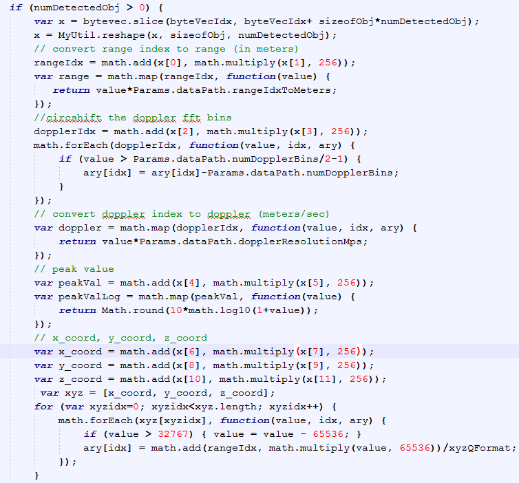

  •  Please find attached also calculation of position of X/Y/Z from your program. If you look to calculation you do next:
    X_Pos = ((X_Ret * 65536) + RangeIdx) / xyzQFormat;
    Same for Y/Z. For me looks very strange. Any way please describe very clear this steps. Your documentation has a lot of missleads. For example how to represent: MMWDEMO_OUTPUT_MSG_RANGE_PROFILE.

    When we decode your captured raw data, the first frame looks like this (see attached txt file for the entire parsed data). As you can see, ObjID 3 and 4 are outside of the plot range and not shown in the plot.
    It appears that you are interpreting the X, Y and Range Profile data incorrectly. The X, Y, Z coordinates and the range profile are sent out in the Q format which is a fixed point number format ( en.wikipedia.org/.../Q_(number_format) ). The number of fractional bits for the X, Y, Z coordinates is specified separately in the xyzQFormat field at the start of the MMWDEMO_OUTPUT_MSG_DETECTED_POINTS TLV, and appears to be 9 for all your raw data.
    This is documented here in the SDK:
    file:///C:/ti/mmwave_sdk_01_01_00_02/packages/ti/demo/xwr16xx/mmw/docs/doxygen/html/struct_mmw_demo__output__message__data_obj_descr__t.html
    The number of fractional bits for the range profile is 9 for xWR16xx.
    In your case, the xyzQFormat for all detected object data is 9, so to convert the int16_t x/y/z coordinates to metres, you would divide by (2^9).
    Anand

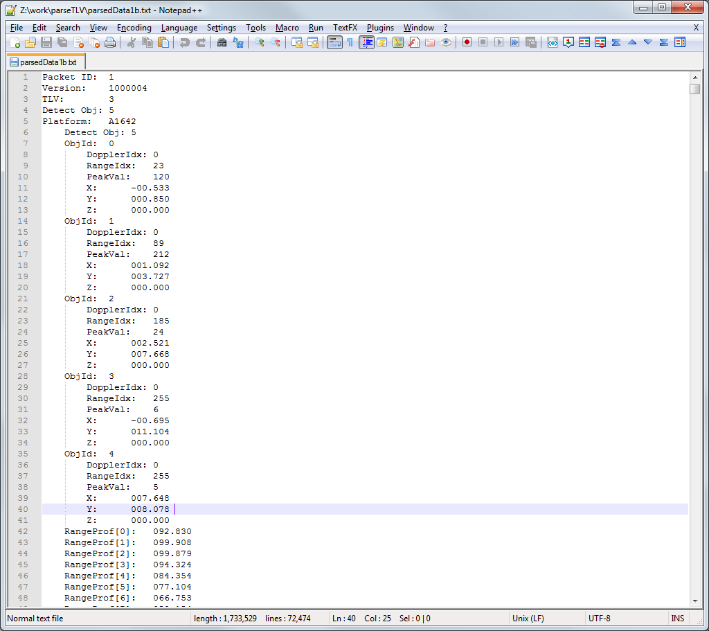

    I made a mistake in the parsing, but the conclusion is still correct - some objects are not shown because the coordinates exceed the plot limits. Please find attached an updated parsed file and screenshot of the first frame.
    Anand
    parsedData1b.txt
  • Hi Anand,
    Looks correct. Please also update this information in documentation (because some other people will lost some time to get it).
