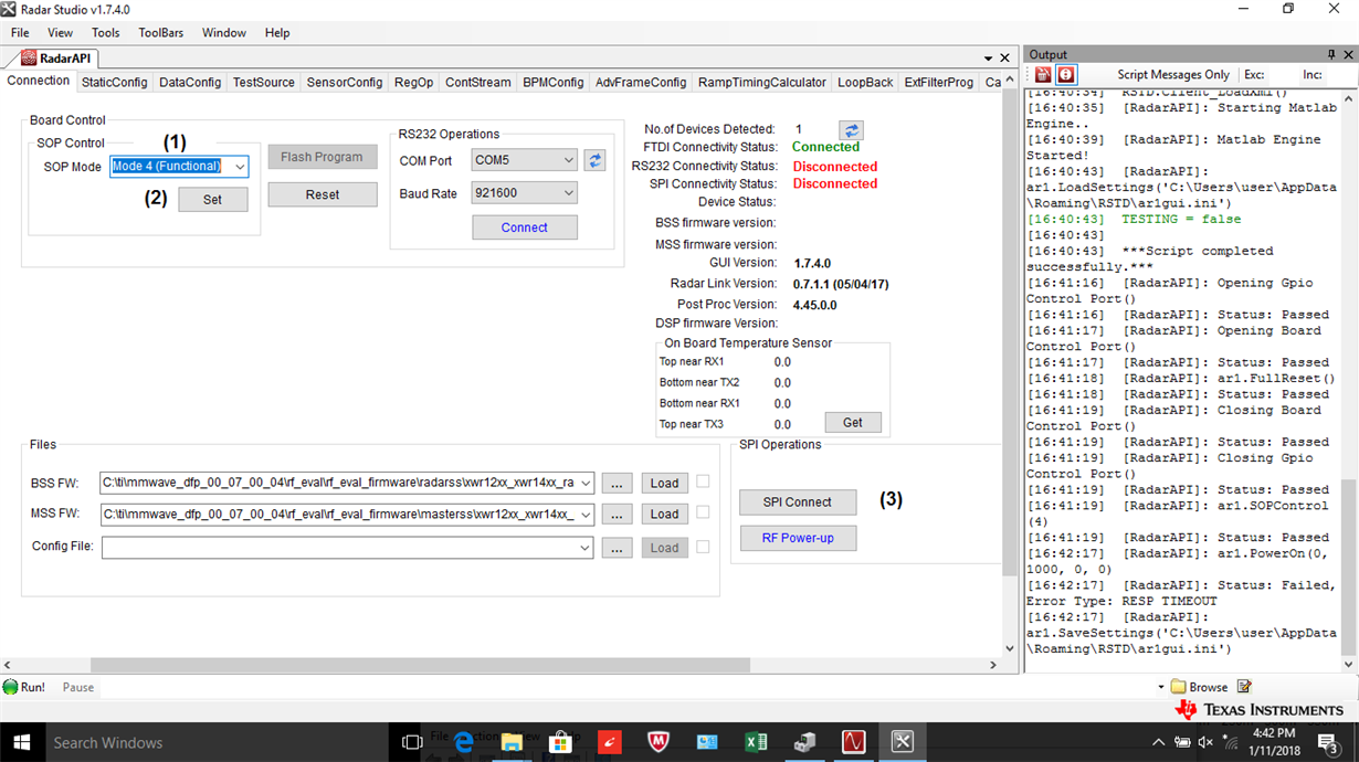

I manipulated Radar studio in the following ways.
But the SPI conection is not possible.
How can I use the SPI conection in "Mode 4(Fuctional)"?
 (1)Select "Mode4(Functional)" .
 (2)Click the "SET" button.
 (3)Click the "SPI Connect" button.
    -> But "SPI Connectivity Status" is disable.
      I want "SPI Connectivity" to "connected".
Iwao Nouchi
    First you need to set Mode 5 (Flash Program) and flash the device (click Flash Program button). Make sure the tick boxes next to the Load for BSS and MSS are checked so that it knows to flash these onto the device.
    After flashing you can go to mode Mode 4, set and connect.
