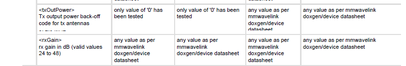

I have noticed one "mistake" that is included in the "mmw_tm_demo.cfg" file that sets the adcbufCfg to "0 1 1 1" , while in the mmwave sdk 1.0.0.5 user guide it say to be set to "0 0 1 1".
Nevertheless, the same error exists for both the adcbufCfg configuration.
