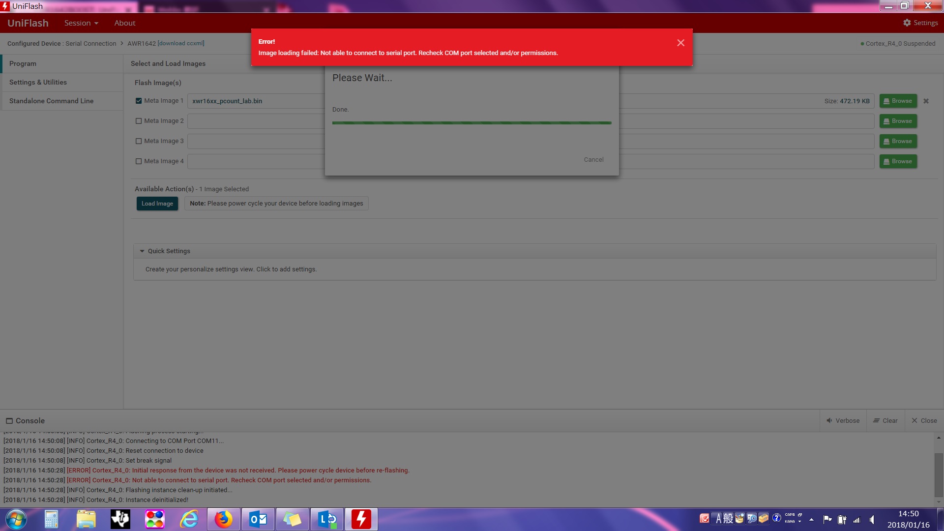

Dear support team;
I want to write the lab data on AWR1642BOOST.
But, uniflash error occurred.
I specified COM11.
And board setting is following.
Could you tell me about that solution method?

  • Dear Akash-san;
    Thank you for your quick relay.
    I tried  other binaries(xwr16xx_pcount_lab.bin).
    But, the same error occurred.
    The following picture is error message.
    I didn't change and add source code.
    I downloaded the mmwave_industrial_toolbox_2_0_0 and selected the binary files under prebuilt_binaries directories.

  • Dear Raghu-san;
    The capability of AC-Adopter is 5A.
    The previous post is real current value.
    By the way, Uni Flash can recognize the AWR1642BOOST.(device auto detected)
    But Uni Flash loading is error.
    Do you think what is reason?
     Masaaki Sugiyama
  • Hello Sugiyama-san,
    The power supply is fine. Please do not use the "Auto-detect " feature. There are some known issues with "Auto-detect" feature.
    Can you manually select the device and try to flash?
    -Raghu
  • Dear Raghu-san;
    I tried manually select the device (AWR1642 and AWR1642BOOST).
    Could you help me ?
     Masaaki Sugiyama

  • Dear Raghu-san;
    I checked verify connection by CCS.
    I attached the error message.
    [Start]
    Execute the command:
    %ccs_base%/common/uscif/dbgjtag -f %boarddatafile% -rv -o -S integrity
    [Result]
    -----[Print the board config pathname(s)]------------------------------------
    C:\Users\SUGIYA~1\AppData\Local\TEXASI~1\
        CCS\ti\0\0\BrdDat\testBoard.dat
    -----[Print the reset-command software log-file]-----------------------------
    This utility has selected a 100- or 510-class product.
    This utility will load the adapter 'jioxds110.dll'.
    The library build date was 'Dec 11 2017'.
    The library build time was '12:04:14'.
    The library package version is '7.0.100.1'.
    The library component version is '35.35.0.0'.
    The controller does not use a programmable FPGA.
    An error occurred while hard opening the controller.
    -----[An error has occurred and this utility has aborted]--------------------
    This error is generated by TI's USCIF driver or utilities.
    The value is '-260' (0xfffffefc).
    The title is 'SC_ERR_XDS110_OPEN'.
    The explanation is:
    An attempt to connect to the XDS110 failed.
    The cause may be one or more of: no XDS110 is connected, invalid
    firmware update, invalid XDS110 serial number, or faulty USB
    cable. The firmware and serial number may be updated using the
    xdsdfu utility found in the .../ccs_base/common/uscif/xds110
    directory of your installation. View the ReadMe.txt file there
    for instructions.
    [End]
    Could you advice me?
    Masaaki Sugiyama
    You don't seem to have run the firmware update command.
    In addition, if it is blank EVM, you need to execute below 2 command :
    Xdsdfu.exe -b boot_loader.bin –r
    Xdsdfu.exe -f firmware.bin –r
    Please run this command and you should be able to update to new firmware.
    -Raghu

  • Dear Raghu-san;
    I am sorry for late replay and thank you for your great support.
    I think that this is hardware issue.
    I will buy the new AWR1642boost.
    I close this thread once.
    Masaaki Sugiyama
