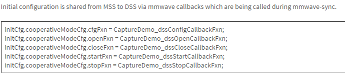

Initial configuration is shared from MSS to DSS via mmwave callbacks which are being called during mmwave-sync.
initCfg.cooperativeModeCfg.cfgFxn = CaptureDemo_dssConfigCallbackFxn; |
And the decision of controlpath on MSS/DSS is taken based on gDemoCfg which is being written by MSS on HSRAM memory.
