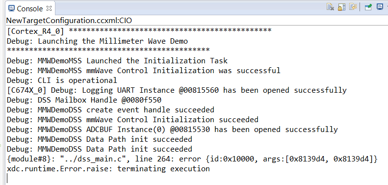

What causes this kind of mistake?
If you apply a breakpoint in the oob demo, there will be a crash since some of the deadlines will be missed.
Please search this forum for "breakpoint" and you will find other threads discussing the same topic
