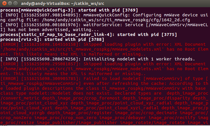

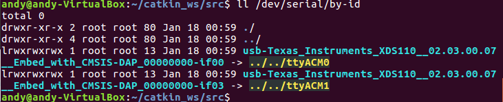

    I tried with the oracle virtualbox, then the above issue doesn't happen. I faced another issue after execute the below command to run the mmwave ROS driver, the error is as below screenshot. I confirmed the flashed image from sdk 1.1.0.2 work well, and checked the serial port in VM with below figure. Would u pls help instruct me how to fix it? thanks.
    roslaunch ti_mmwave_rospkg rviz_1642_2d.launch

  • Hi Andy,
    This is a known issue in version 1.6.2 of mmWave Industrial Toolbox. The details of the issue and the corresponding fix have been documented in the following post.
    https://e2e.ti.com/support/sensor/mmwave_sensors/f/1023/p/619401/2282554#2282554
    This was fixed in mmWave Industrial Toolbox version 2.0.0. You can either apply the fix as detailed in the above forum post or download the latest version of mmWave Industrual Toolbox which includes the fix.
    -Nitin

  • Hi Nitin,
    I am using the mmwave industrial toolbox 2.0.0 for test, but the issue still exists. I checked your known issue post and found the issue still exists in version 2.0.0, after change the file mmWave_nodelets.xml, it can work now.

  • Hi Andy,
    Thanks for bringing this to our notice. It appears that the fix didn't get pulled into the latest release. We'll fix this in the next update and in the meantime , we'll also update the following thread to include mmWave Industrial Toolbox 2.0.0 in the list of affected versions.
    e2e.ti.com/.../2282554
