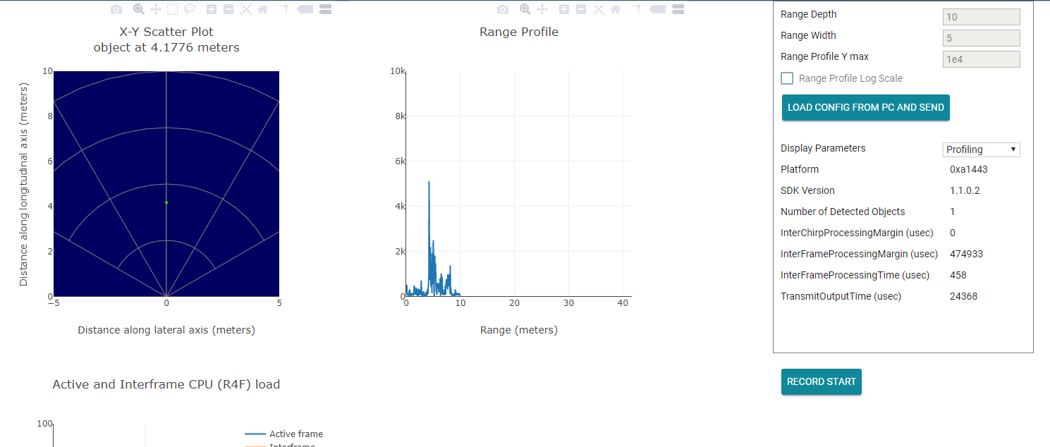

  • We can see the DATA and CFG files by spying on the serial ports on Com 3 and 4.
    Will we see similar data if we look at the IWR1443 RS232 pin?
    What is baud rate at the IWR1443 RS232 pin?
    Cannot find the function in the mmwave project. Cannot find structure of output. Only saw the declaration.
    void MmwDemo_transmitProcessedOutput(UART_Handle uartHandle,
    MmwDemo_DataPathObj *obj);
    I think your magicWord in your output format document should be 02 01 04 03 06 05 08 07
    Below is the data we received. Where is the meter distance in this package? Visualizer says 5.2837 meters

    We are trying to look ahead with our hardware design using the high accuracy lab as a starter.
    We cannot see data on AR_RS232_TX and RX using a scope with the visualizer on high accuracy. Does it go into the XDS110 on another port such as SPI or SCI?
    The AR_BSS_LOGGER has scope activity so we suspect that is where the visualizer data is going into the XDS110 to the PC.
    Where is this CONFIG data go into the IWR1443 for the high accuracy lab ?
    We thought that we could see data on AR_RS232TX at 921600 for DATA and AR_RS232RX 115200 for CONFIG.
    Are the AR_RS232RXTX ports used at all in the high accuracy lab visualizer?
    Is the TMDSEMU110-U a good XDS100 device to use for our production board?
    You mention tabs to see the CONFIG page on the Visualizer. Sorry, but we cannot find it on the red banner (below). Akash mentioned that we would not see the Config tab with the high accuracy lab project.
