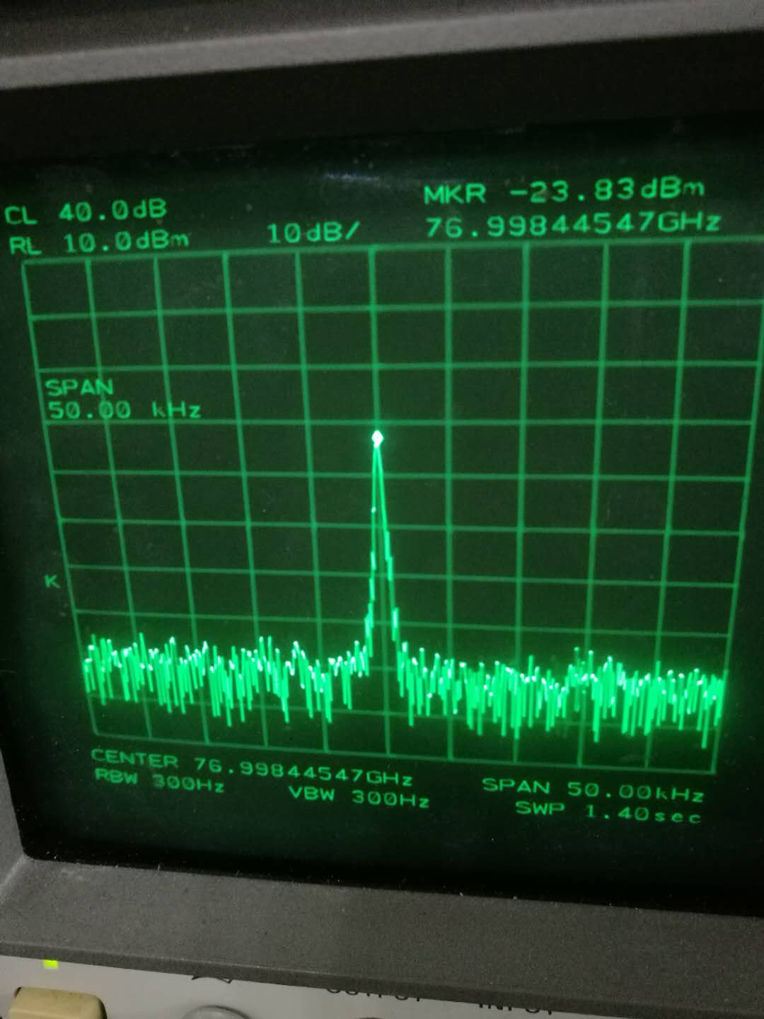

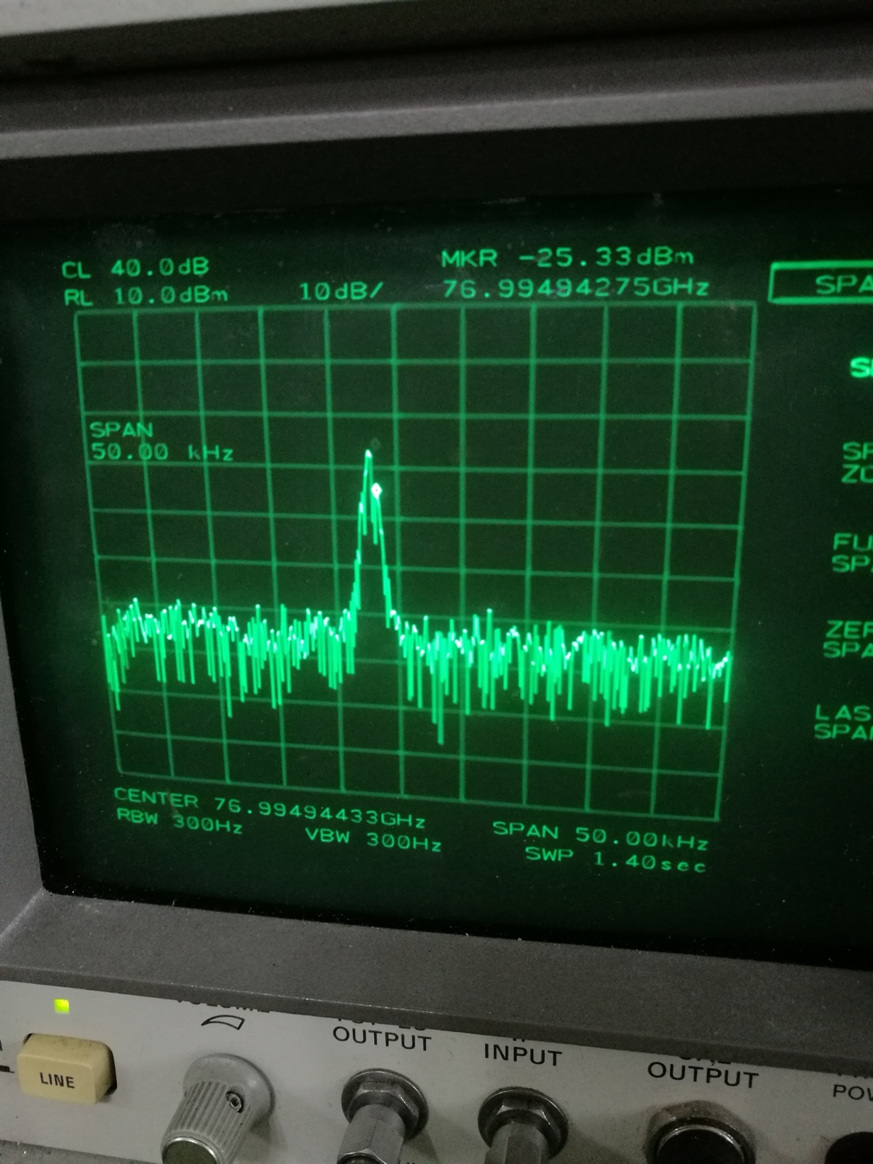

My customer is testing the phase noise in continuous wave mode. Compare with AWR1642EVM, customer’s own AWR1642 board’s phase noise isn't good enough.
Can you please check with this configuration, is phase noise will be influenced by the configuration?
Also, can you please give some advises that can help to improve the phase noise?
I have attached customer’s configuration and the test result.
SDK: mmwave_sdk_01_01_00_02
Demo: Capture demo run in Continuous wave mode
Customer’s configuration:
sensorStop
flushCfg
dfeDataOutputMode 2
channelCfg 2 1 0
adcCfg 2 2
adcbufCfg 0 0 1 1
lowPower 0 0
contModeCfg 77 0 0 6000 0 0 30 1 1024
sensorStart
Test result on AWR1642 EVM is shown below
Test result on Customer’s AWR1642 Board is shown below.
