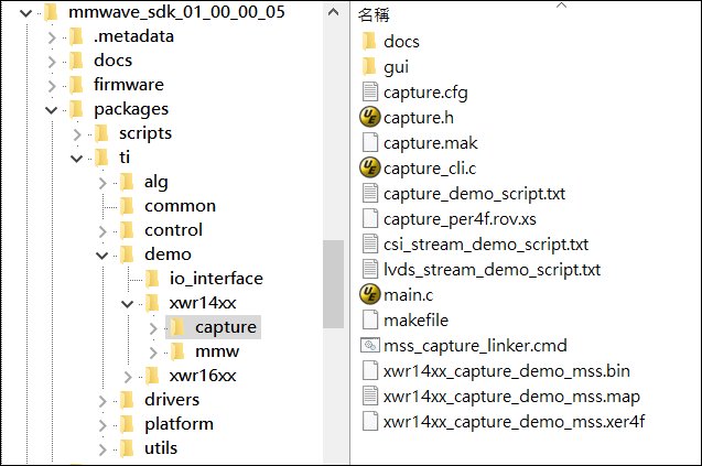

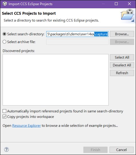

How can I build the Capture project in CCS? Do I need to create project?
  • Hello WJ,
    mmWave-SDK package doesn't provide CCS project in the installer. To build Capture demo with CCS you need to create a CCS project for it.
    To create a CCS project you can take reference from TI resource explorer (mmWave Training).
