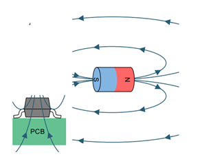

Hi Expert,
If I use DRV5032FA, but the contact method is by horizontal direction. Does DRV5032 can detect it? Thanks!
Hello Jerry,
Yes, it will. Figrure 24 on page 19 of the datasheet talks about exactly this.
Harsha
