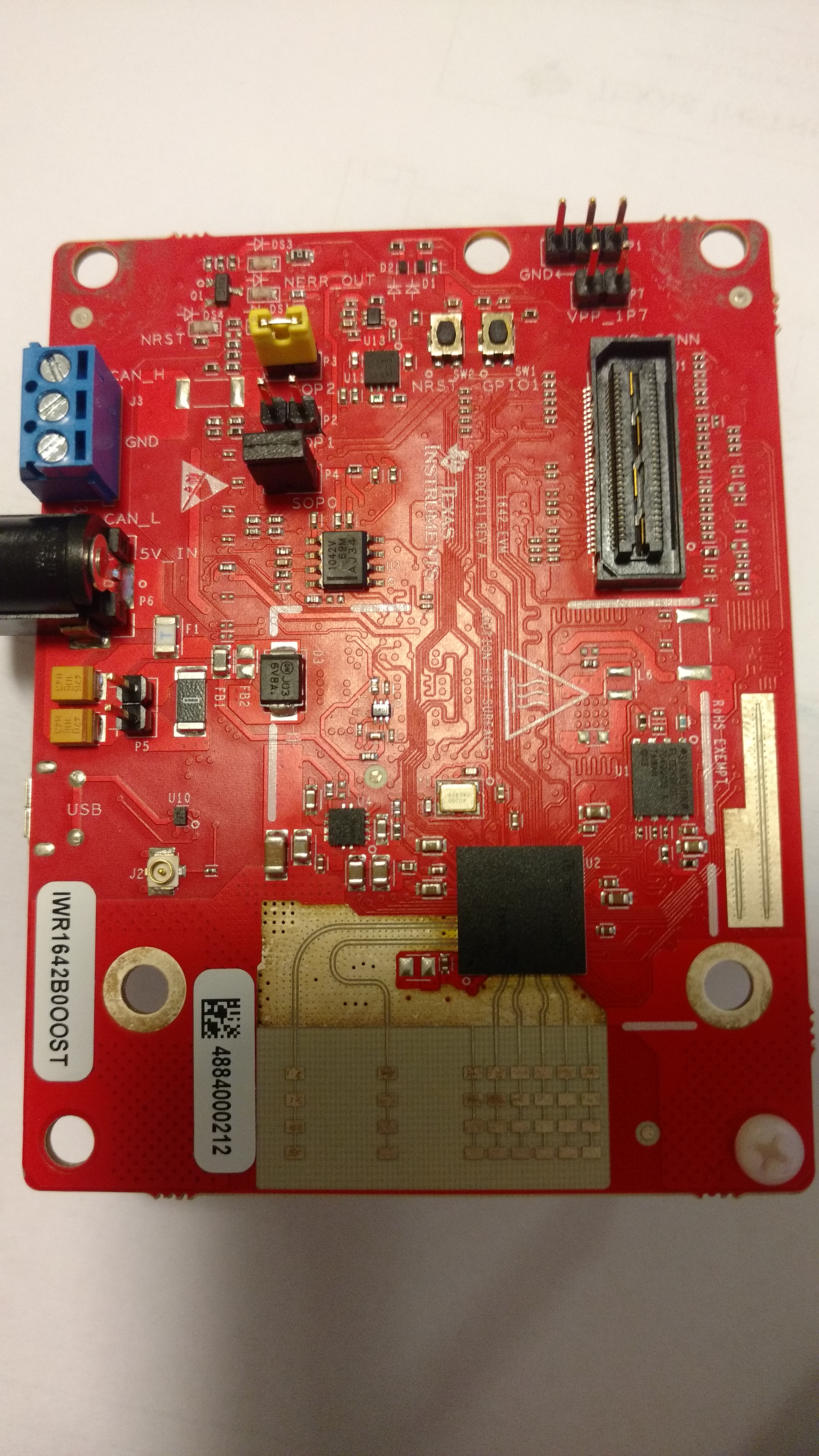

my IWR1642BOOST is not booting properly. After powering the board the 5V red led and the yellow NRST led are blinking.
I'm unable to connect to the serial port for flashing.
Can you help me to understand what's going on?

Hi Luca,
Please ensure that you are powering the board with a 5V 3A DC supply. Check to see if you have any jumpers on the board. To flash software on the board, SOP0 and SOP2 need to have jumpers. To run flashed software, SOP0 needs a jumper. To use the Dev Pack with Radar Studio, SOP0 and SOP1 need jumpers.

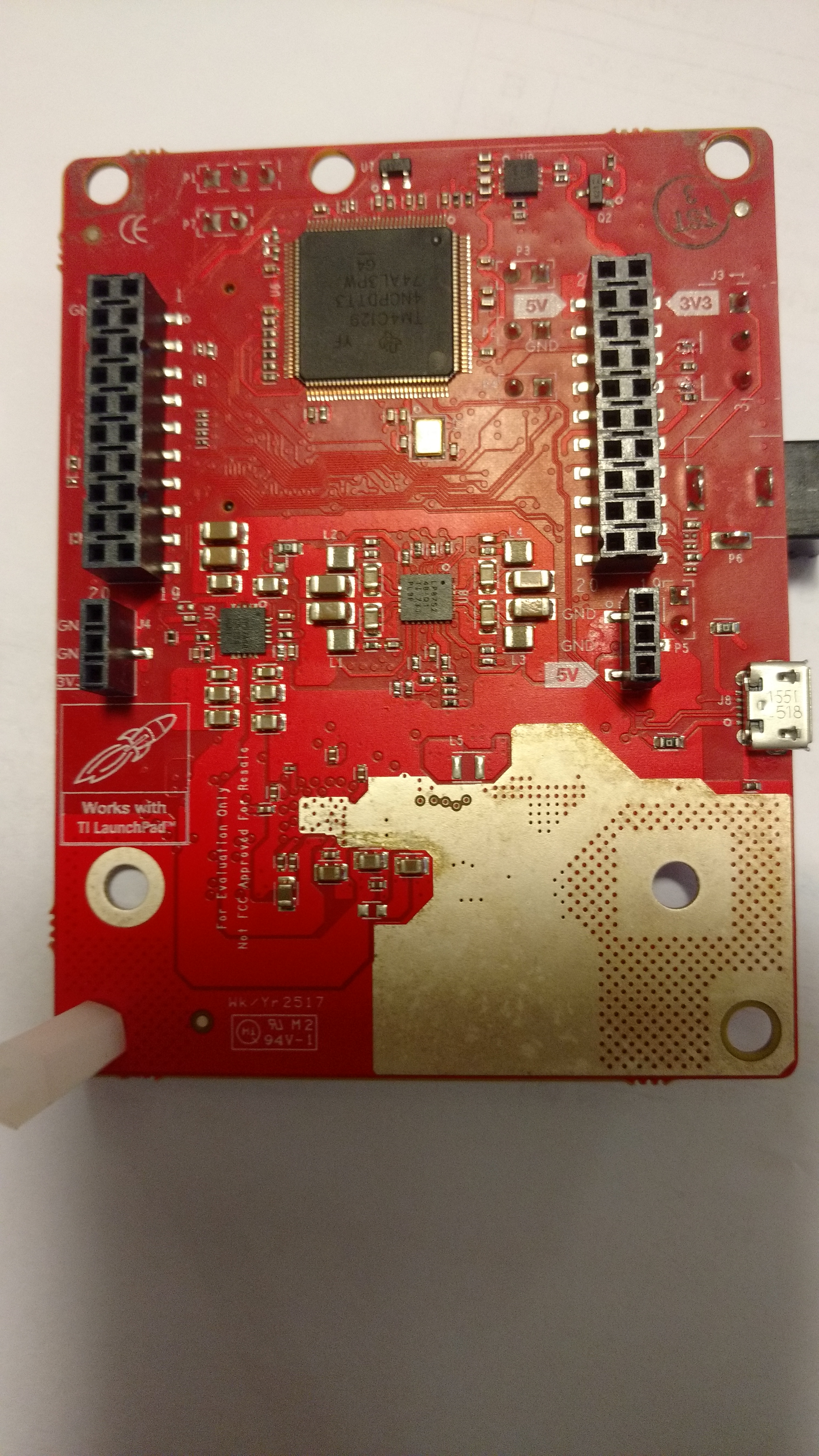

Have you made any modifications to the board or flashed any software? Is there any visible damage? If so, can you send a picture?
Justin
Hi Justin,
The power supply is 3A and there's no visible damage on the board as you can see in the attached images. The only modifications made on the board is for routing the UART to J5 connector (soldered R169 and R166, removed 0ohm from R128 and R129).
The jumper on SOP0 is present and also on SOP2 because I've alredy tried to load an image on this board and it was working but now the two led are blinking and the pc does not see the COM port (neither the cfg com port nor the data port)
Luca
Actually I'm using an external FTDI 3.3V USB to serial converter attached to J5 so I have the cfg COM here and the data COM out of the micro USB connector.
But the problem is that the board seems not powerd correctly because the 5V led is not glowing as before, it's blinking continuously.

Hi Luca,
Can you measure the voltage on the 5 V and 3.3 V pins with the board powered on? If possible, can you check to see if any GPIO pins are shorted with Ground?
Justin
Hi Justin,
yes, we should have solved the problem. Seems that D3 on the board was damaged.
