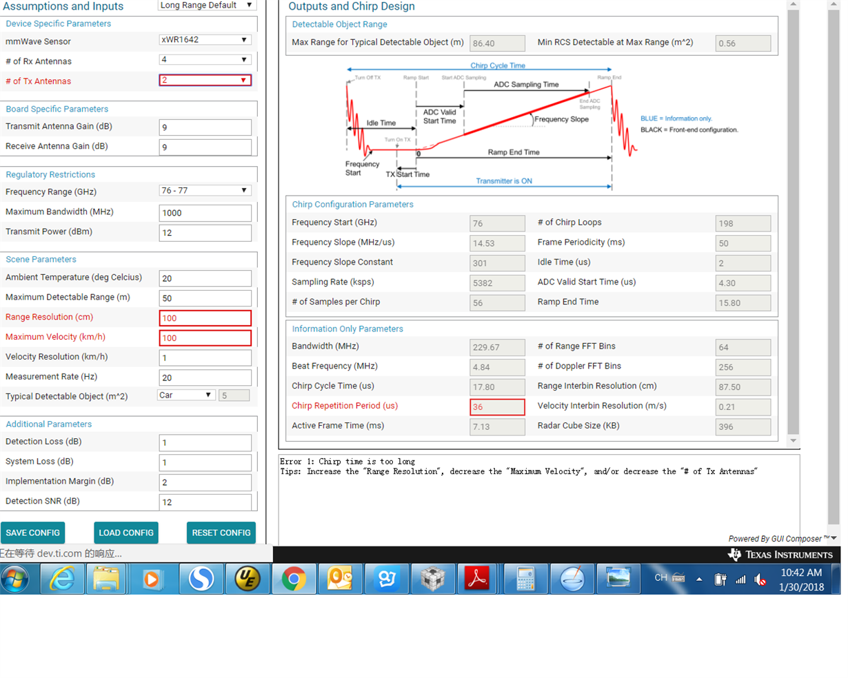

Using the mmwave sensing estimator to get the chirp configuration as below figure, it reminded the chirp period is too long, but based on my calculation all the parameters are correct, would u pls help let me know why it reminded such error, any limitation?

    I referred to the SWRA553 to calculate the d_max, d_res, v_max and v_res, all can match, and beat frequency in the above map is 4.84MHz which is less than the IF BW 5MHz. I cannot understand why it reports such error. Need your help to clarify, greatly thanks.

  • Andy,
    If you decrease the number of TX antennas down to 1, then you can leave all of your other parameters the same and you will not receive any errors.
    Kyle
  • Hi Kyle,
    Yes u r right the error disappear if decrease the number of Tx antennas to 1. But i cannot understand why it reports such error if number of Tx antennas is 2, would u pls help let me know why? We need to know the root cause to get the optimal RF parameters.
    Thanks.
    Andy
  • Andy,
    We are looking into this issue further. The reason this particular chirp configuration throws an error is related to the maximum velocity resolution that is specified by the user. In this case, you input a maximum velocity of 100 km/h. However, based on the chirp configuration that is generated by the tool, the maximum velocity is calculated to be 99.72. If you were to simply change the maximum velocity from 100 to 99, all errors would go away. Additionally, changing the frequency range from 76-77 to 77-81 removes all the errors, but this is due to the change in the carrier frequency. This is detailed more below.
